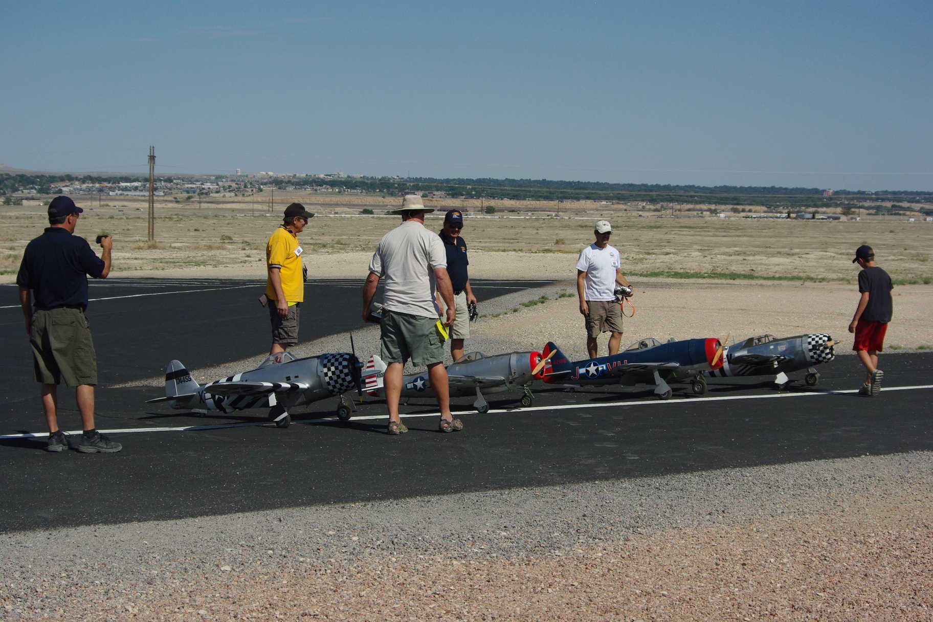

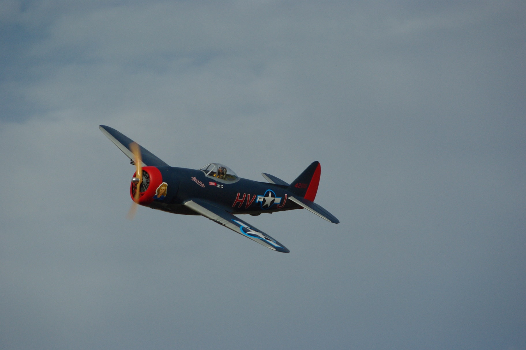

Here's some pics from one of our recent events. The four 47s were powered by , left to right 3w 75(i think) sachs 4.2, Brison 5.8 and a DA 100.
two are Ziroli, one TF and one Vailly. Pilots left to right, CD Duane Pisciotta, Clark Graves, Doug Knowlton, Brent Cozzolino, Ken Montblat and Zach Cozzolino. The second photo is a TF corsair kit powered by an old (very old ) orange case sachs 4.2 and the third is a Ziroli with a Brison 5.8
Guess which one is fastest? If you said the Corsair your right! Very old Sachs 4.2 cut from a chainsaw in the early 90's, propped with a Menz 22X10 but runs really well with a TF 22X10. Weight is right at 30lbs so it's no feather weight.

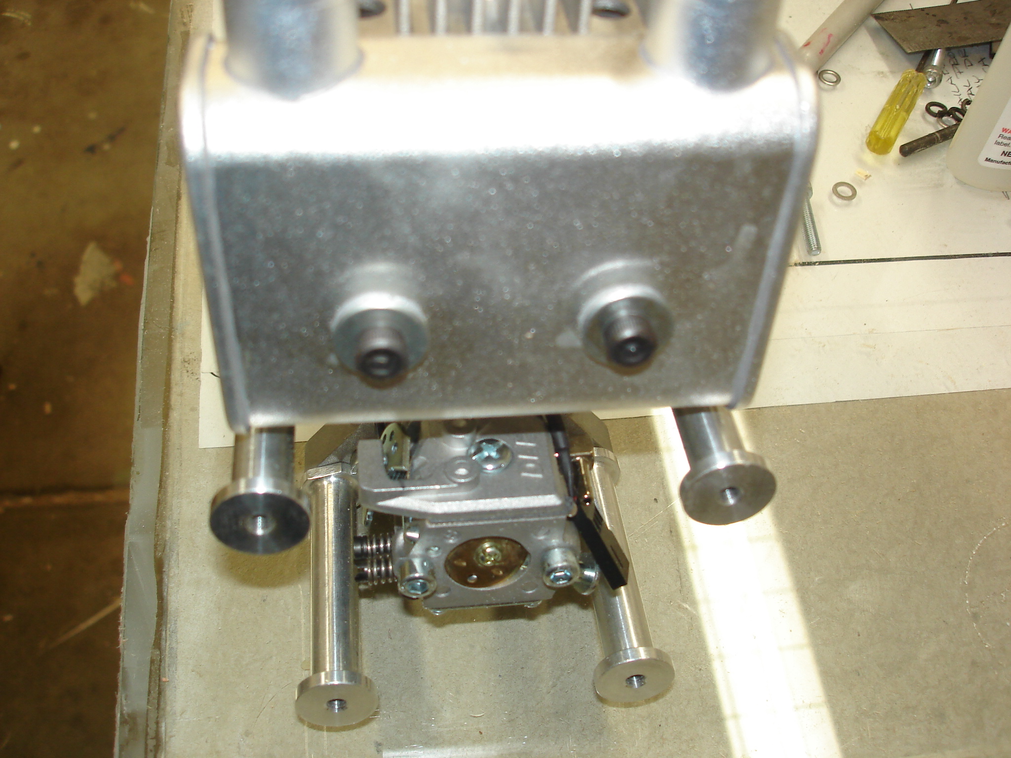

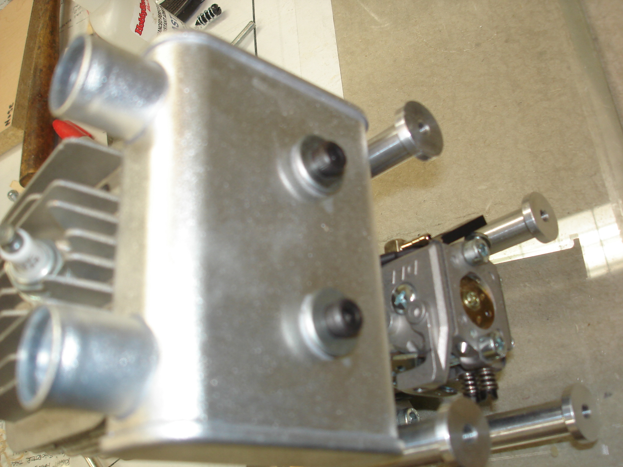

I bought long muffler bolts for my DLE 55 and put washers behind the bolt heads to fully force the whole muffler against the engine. Stock, only the inside part of the muffler is bolted on. This is the area of failure.

Yes, thank you. I'm seeing a pair of fender washers on the extended length bolts?

Not sure the exact size, I can post a pic when I get home. It just has to be big enough to cover the hole. 1/2" maybe? I think this is really a non issue and a simple mod really. Much less of an issue than trying to get those wrap around mufflers to hang on with the side exhaust engines. With those a clamp has to be fabricated to attach the other side of the muffler to the engine. That is a notorious issue.

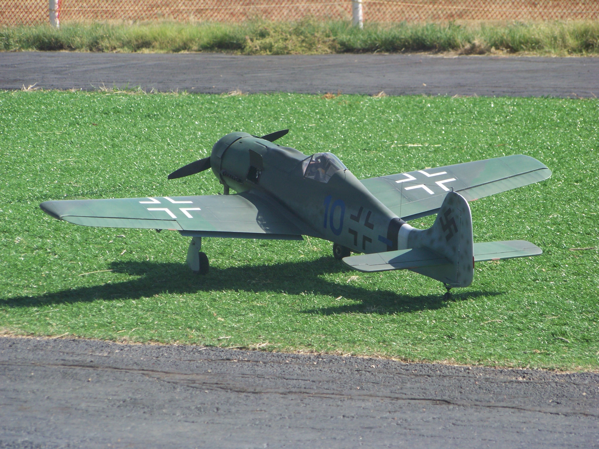

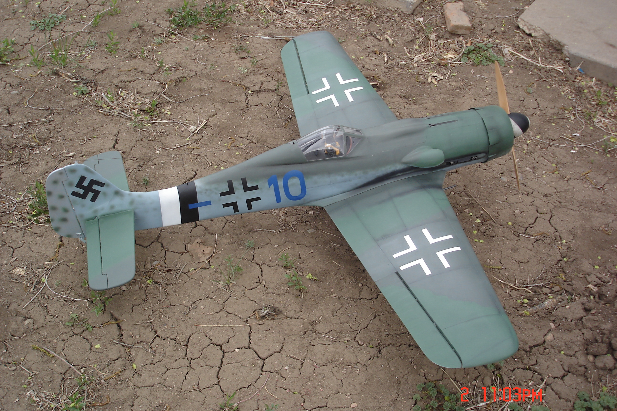

Here are a few of my DLE 20 powered Pica FW 190 D9. Perfect combo. Tons of power for this plane. Been flying it now for 3 seasons with this engine. Only had to touch the needles a couple of times during this period. Rear intake needles are easy to get to, with a small access hole in fuselage. I have a long screwdriver for this, and I paint the heads of the screws white, to cast light on them in a dark place. Works very well.

DLE 55 muffler mount mod.

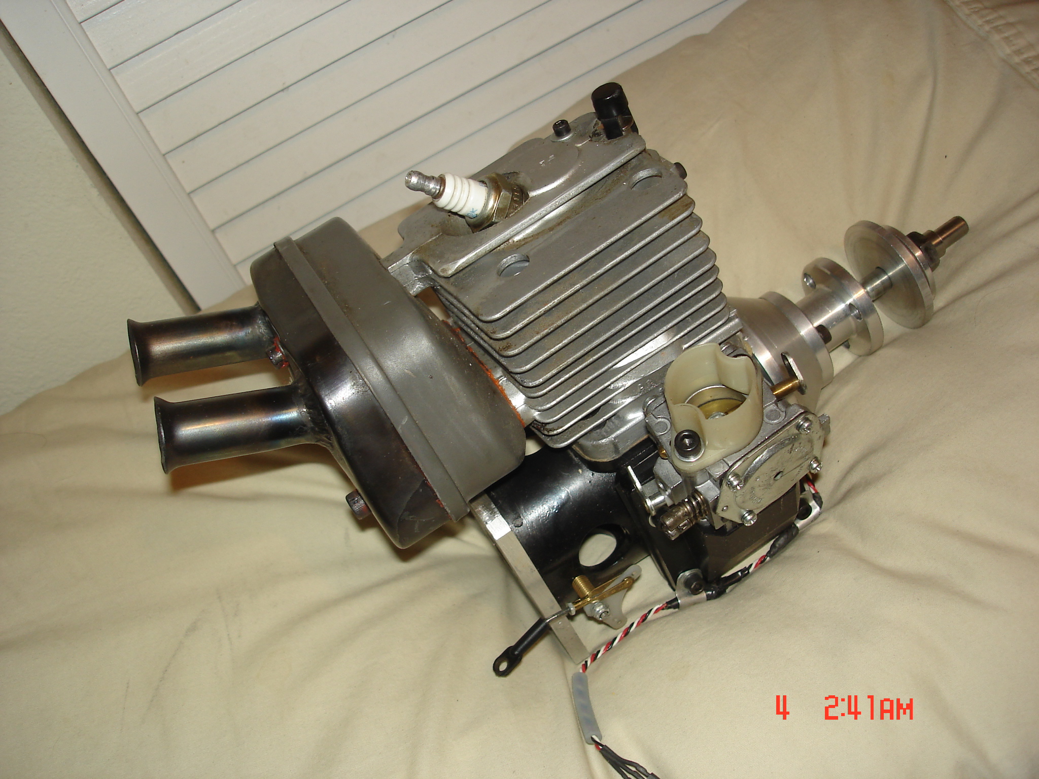

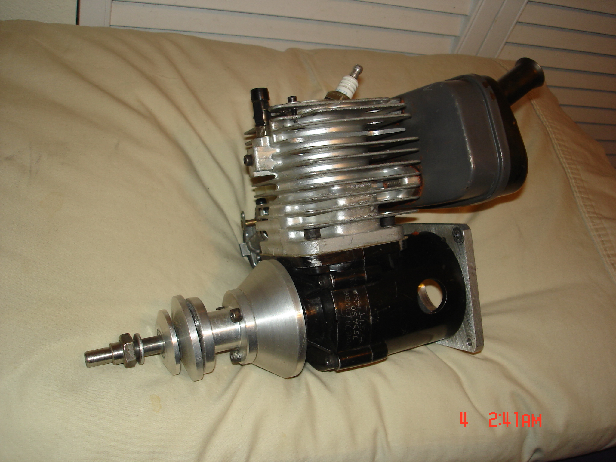

Here are some pics of the Q75. It has that compression release on the top of the cylinder. These are supposed to be serious stump pullers. I really do not plan on building anything big enough for this engine right now.

Do you have the ignition with the engine?

I do, it was just not pictured. It is C and H. I also have a synchro spark to go with it. It is in great shape. Let me know if any of your southern buddies are interested. I could just ship it down there if they would like.
