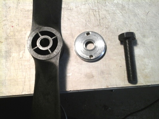

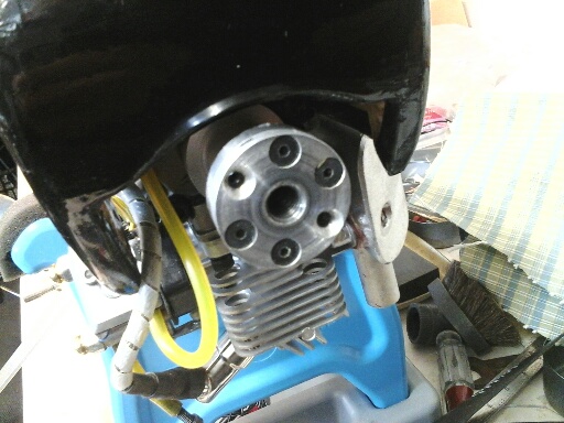

I'm wondering if there is an easy way to mount a nylon prop on a un-knurled prop hub face.
An example of a smooth (un-knurled) hub of an SPE 26cc engine is shown. The back of the nylon
Master Airscrew (and many other nylon props) prop hub has molded in spaces that do not allow a drill
to track straight when using the prop washer as a drill guide. The drill is trying cut into half of the nylon.
The drill never goes thru straight. This, of course does not happen with a wooden prop.
When trying to mount without drilled bolt holes thru the prop hub, the prop will spin loose. Short of milling the little bolt holes
out with an end mill, is there another way to drill this out? Or is there something that can be used as a locking
washer between the back of the prop and the aluminum prop hub?

A disk made of sand paper will help. Make two disks and glue them together back to back

Yep, that works well. And use a prop hole reamer when enlarging the center hole in any type of prop.

Just tried the sand paper suggestion. Works great!
