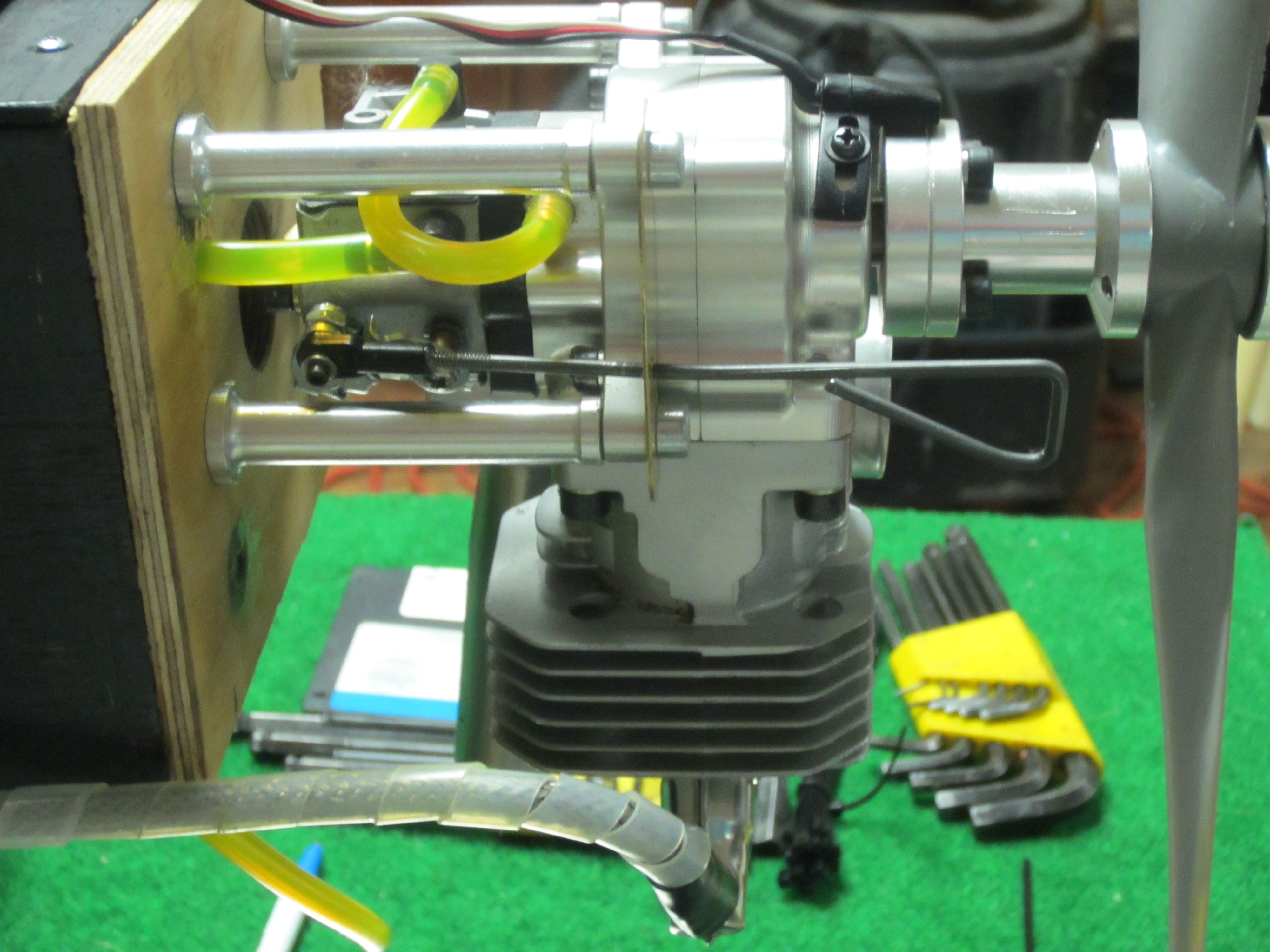

They do have this choke it is a 20 cc rcgf rear induction motor. Maybe they don't make it any longer
Has a walbro carb. It has a spring loaded arm to hold the choke open . Then you lock the choke closed ...
I can show you the pics

Here are the pics see the arm You push that arm to lock the choke closed

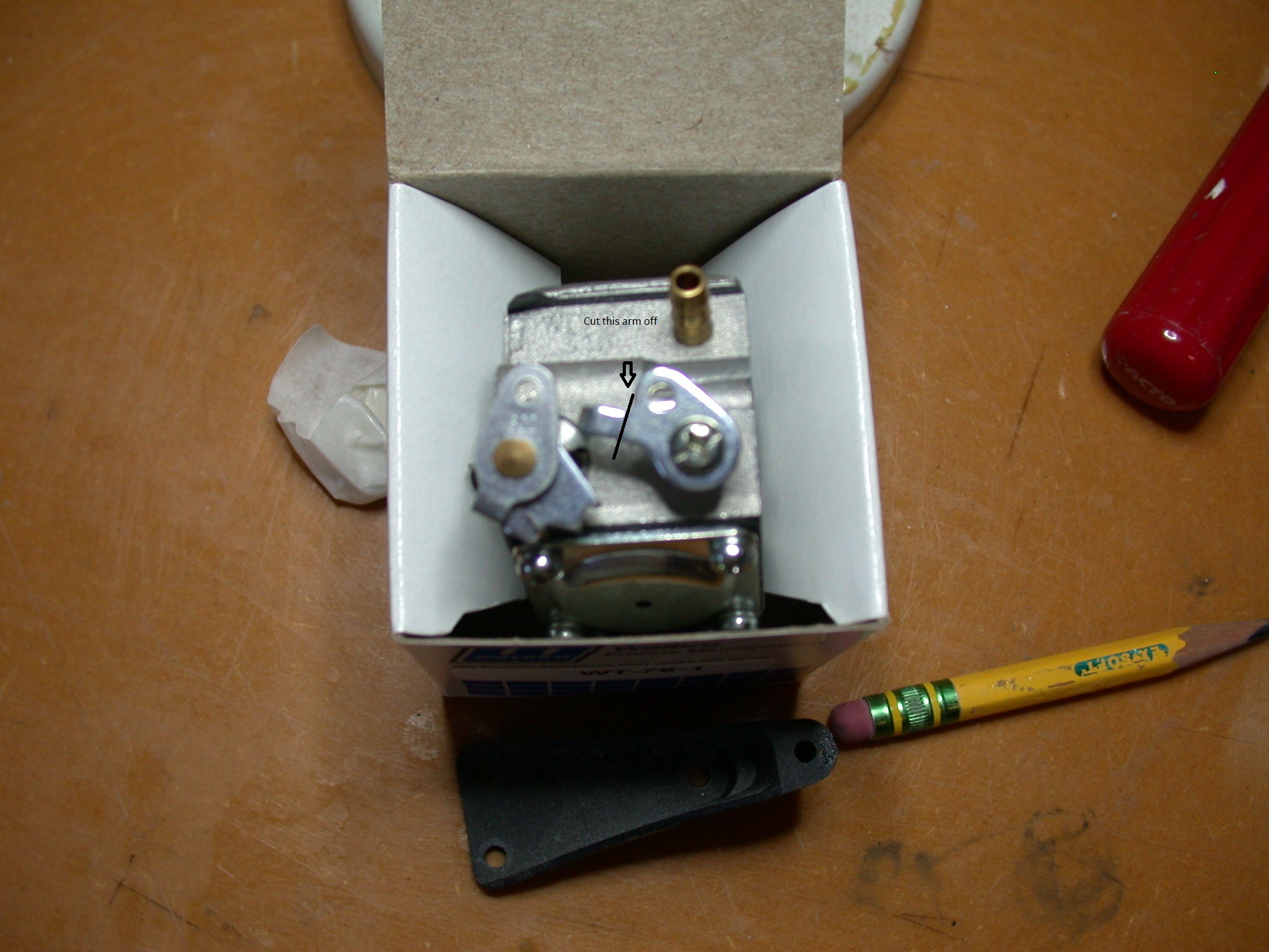

Sorry bud but that is not factory, that was added by a previous owner. You can remove that and hook up to a servo or any means you prefer.

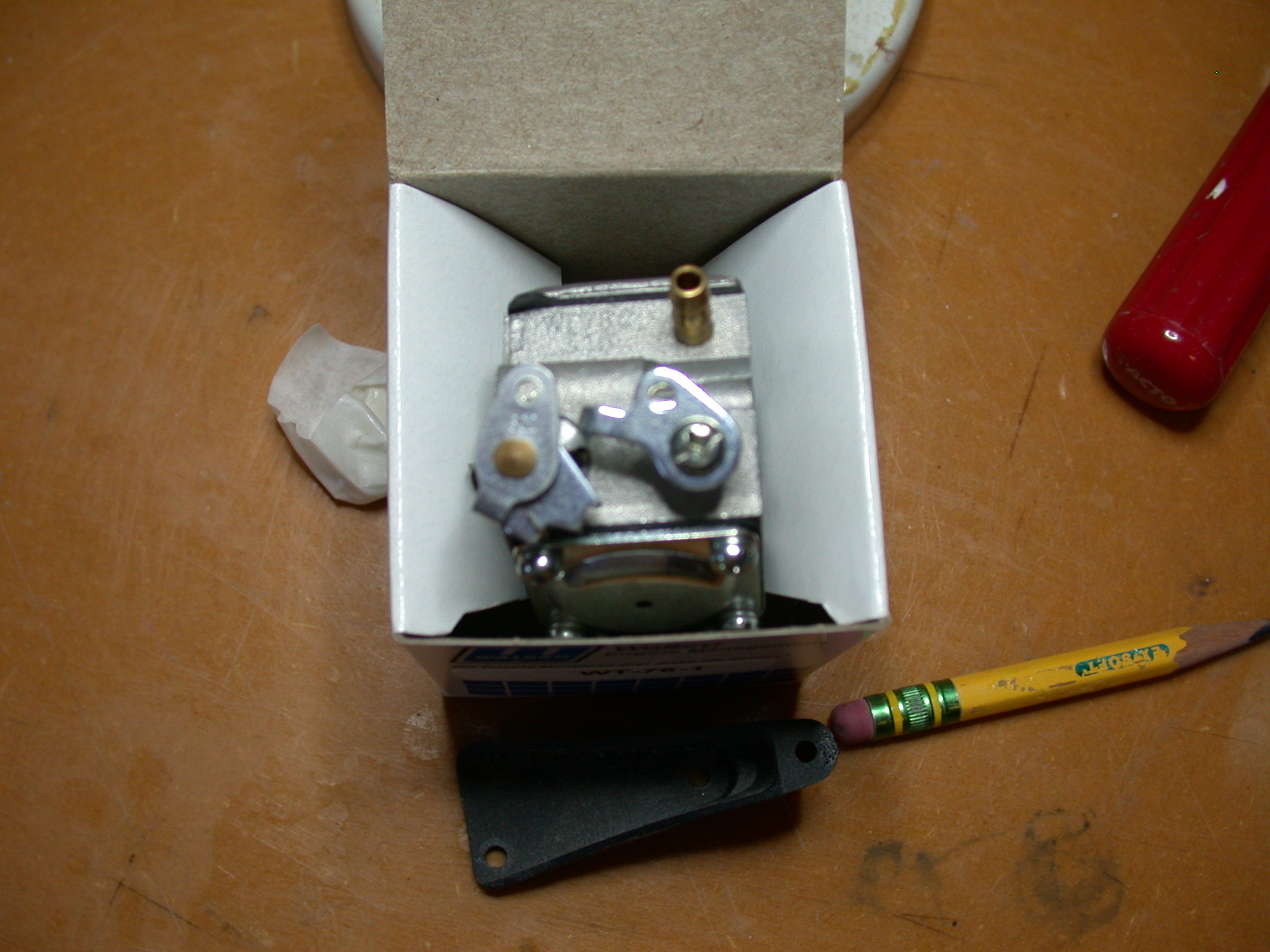

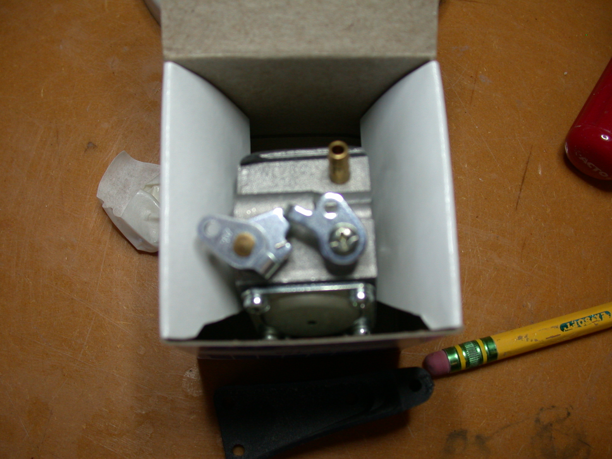

Here’s the factory version on a WT-76-1. The arm on the left is the choke. The one on the right is the throttle. The first image shows the choke arm in the open position. Notice the notch in it. The choke shaft is not detented in position. The second image is with the choke closed. That notch has engaged the throttle arm forcing the throttle plate in to a fixed open position. That’s where the problem is. The throttle pushrod will either inhibit this action, get bent or put a tremendous load on the servo. When the throttle is opened further, the throttle arm releases the notch and the choke pops open. It is going to be terrible trying to live with this action unless someone comes up with a way to inhibit it. Dan.
Ah, I see. I have never seen one on an r/c engine before. Just replace the arms with standard arms such as we do when we need longer or different positioned arms. Or use a Dremel cut off wheel and cut off the dog ears on the choke and or the arm on the throttle. See pic, removing this arm would do the trick would it not?

I don't think that would work. The choke arm must have a spring on it to return it to the open position. If you just cut off the ear on the throttle arm, the spring would prevent the choke from staying closed when you needed it in that position.
So you might say just unhook the choke spring. Well, that might not work either. The chokes we are used to have a detent that holds them in either the fully open or closed position. If that model carb does not have those detents the choke would easily bounce out of the closed or open position just due to engine vibration.
I had one of those choke lock carbs on a Mintor 22. It did work but was a pain in the ass compared to what we usually have on most engines.

Yep my evolution 26 has the same thing. You have to have throttle down and trim down to set the choke. After it pops set trim and throttle to starting positions. The hook the previous owner added was probably to facilitate easier operation inside a cowl.

If this is a 26, there were a lot of guys pretty ticked off with that carb at one time. These 26's were one of the engines that introduced a lot of guys to gas. There was an issue with the pop off pressure set by that little spring, but not many people knew much about that yet. For that reason, a LOT of the OEM carbs were replaced when they would not pump enough fuel - even with a fresh kit installed (the kits don't include that spring!).
This carb, if you defeat that spring loaded mechanism, will not have anything to hold the choke fully open or closed. There's no spring loaded metal ball, or the detent in the choke shaft it engages to hold it in the open or closed position. Point being, if you want to scrap this type choke, it's best to plan on installing another carb.
Second issue is the engine is set up for an external pulse line. No big deal, you just need to be aware. Most carbs take care of this need with a port in the carb flange. This carb flange isn't going to have one of those. So, the new carb (if you go this route) could be adapted by transfering the diaphram cover from the old carb (the one held in place with the single screw?) to the new/replacement carb.

Maybe this will work. Grind off the notch on the choke arm. Disengage the choke return spring. Remove the choke plate. Try to remove the choke shaft. Install a detent ball and spring. Do you guys think this would work? Dan.
