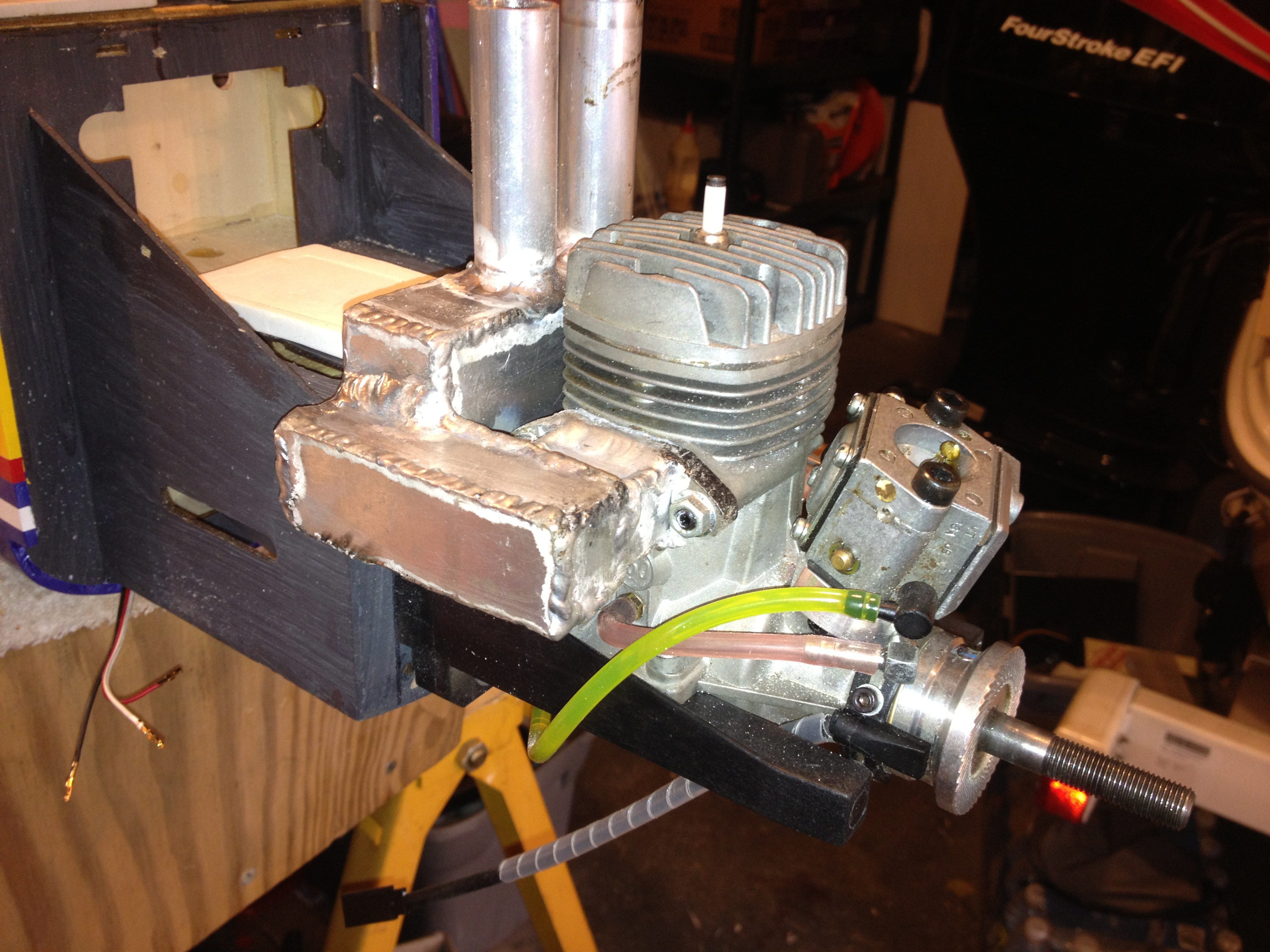

I converted mine to gas, runs great and is a real fuel miser.
