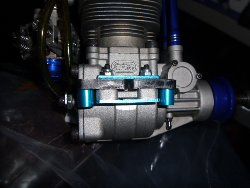

I got these anti vibration motor mounts with the CMP P40 Warhawk check them out -

Old 07-23-2014 | 01:17 PM
earlwb's Avatar
Joined: Aug 2009
Posts: 5,993
From: Grapevine, TX
Those do look pretty interesting. Do let us know how it works out.

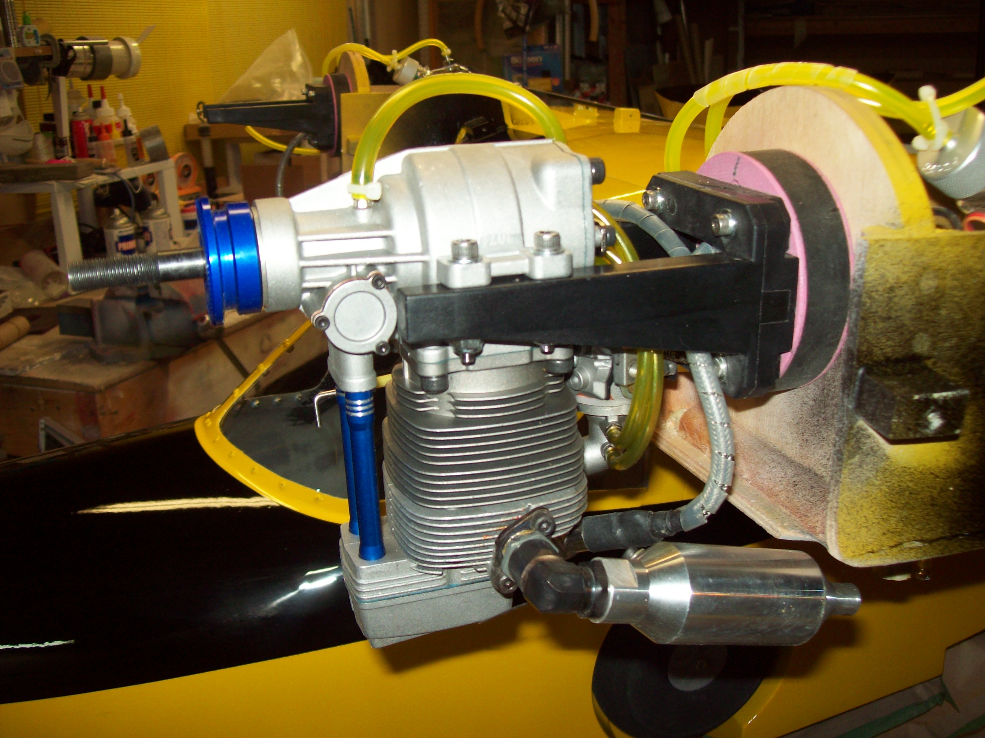

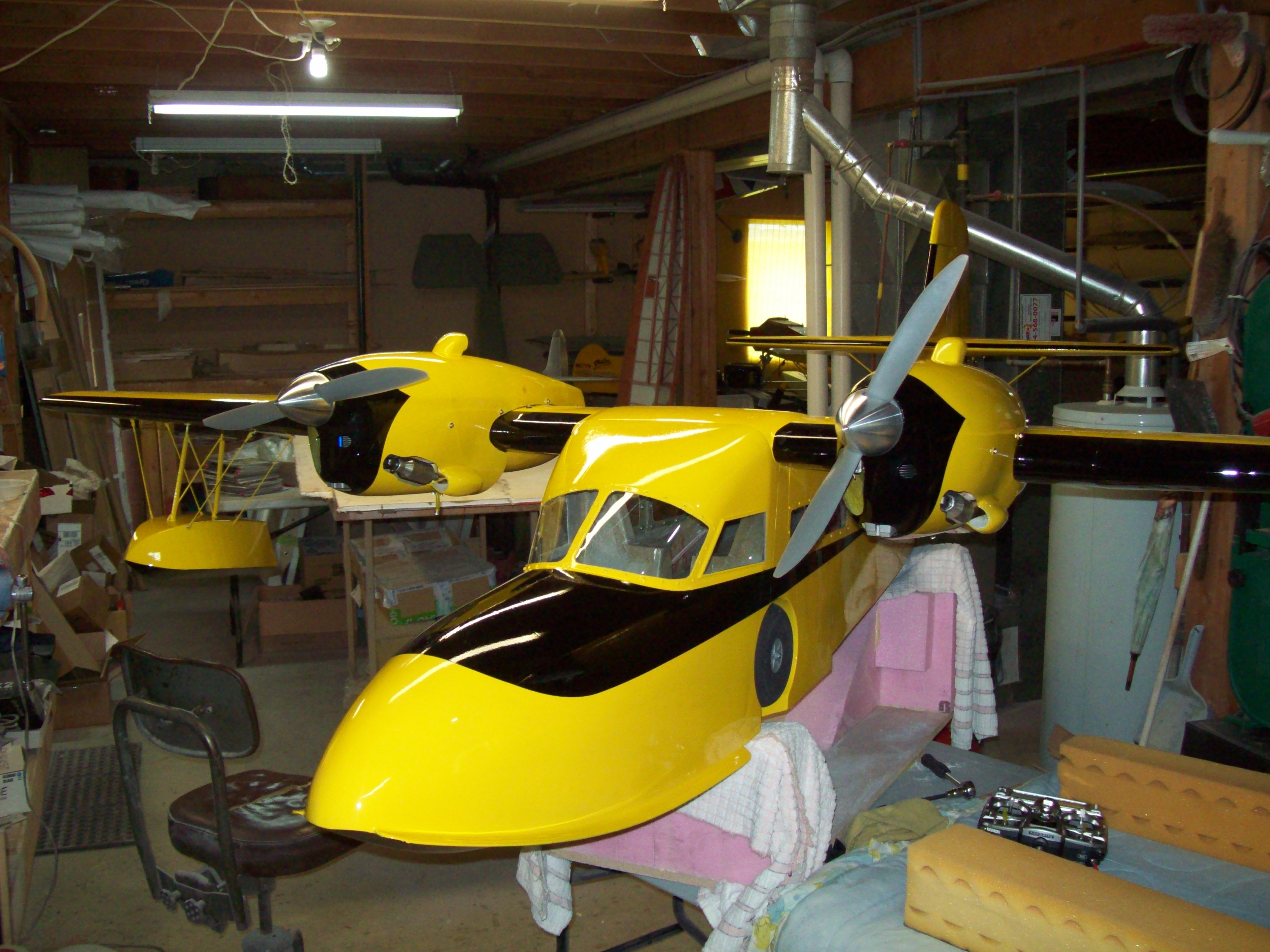

I went with Hyde soft mounts. I used them on my 120" Grumman Widgeon, hasn't flown yet....will be early Sept.
Before anybody comments, the line coming off the crankcase vent terminates at the carb, so any oil ejected from the vent will go into the engine, not all over the outside......seems to work. I have about an hour on each motor breaking them in on a Great Planes giant Ugly Stick. Before I added the Hyde mount, I thought the Ugly Stick was going to shake itself apart.....it didn't!
I'm thinking of using that vent tine to add some lube to the cam before each day's running, after a few runs with the engine inverted, the cam and lifters were pretty dry.
