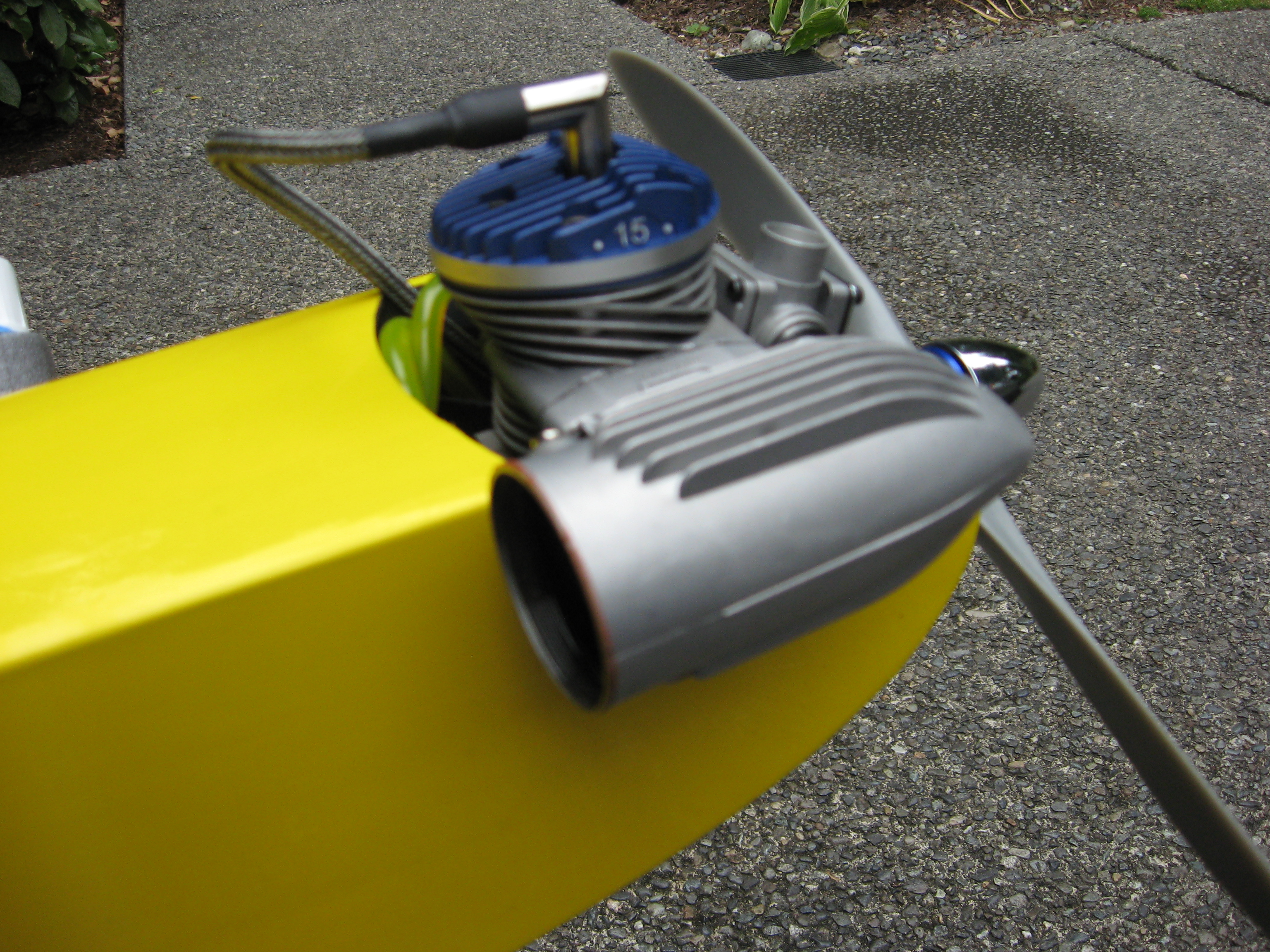

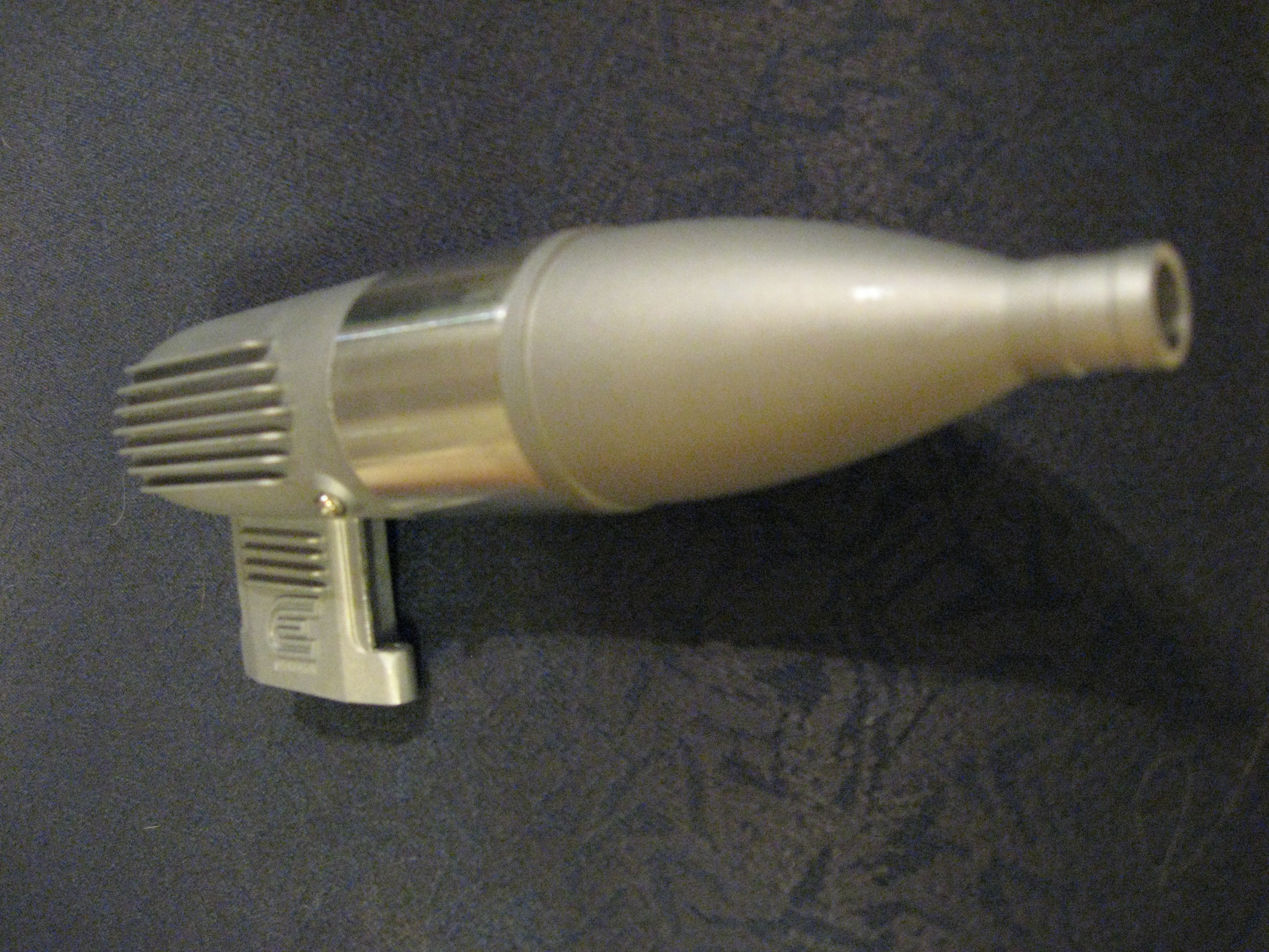

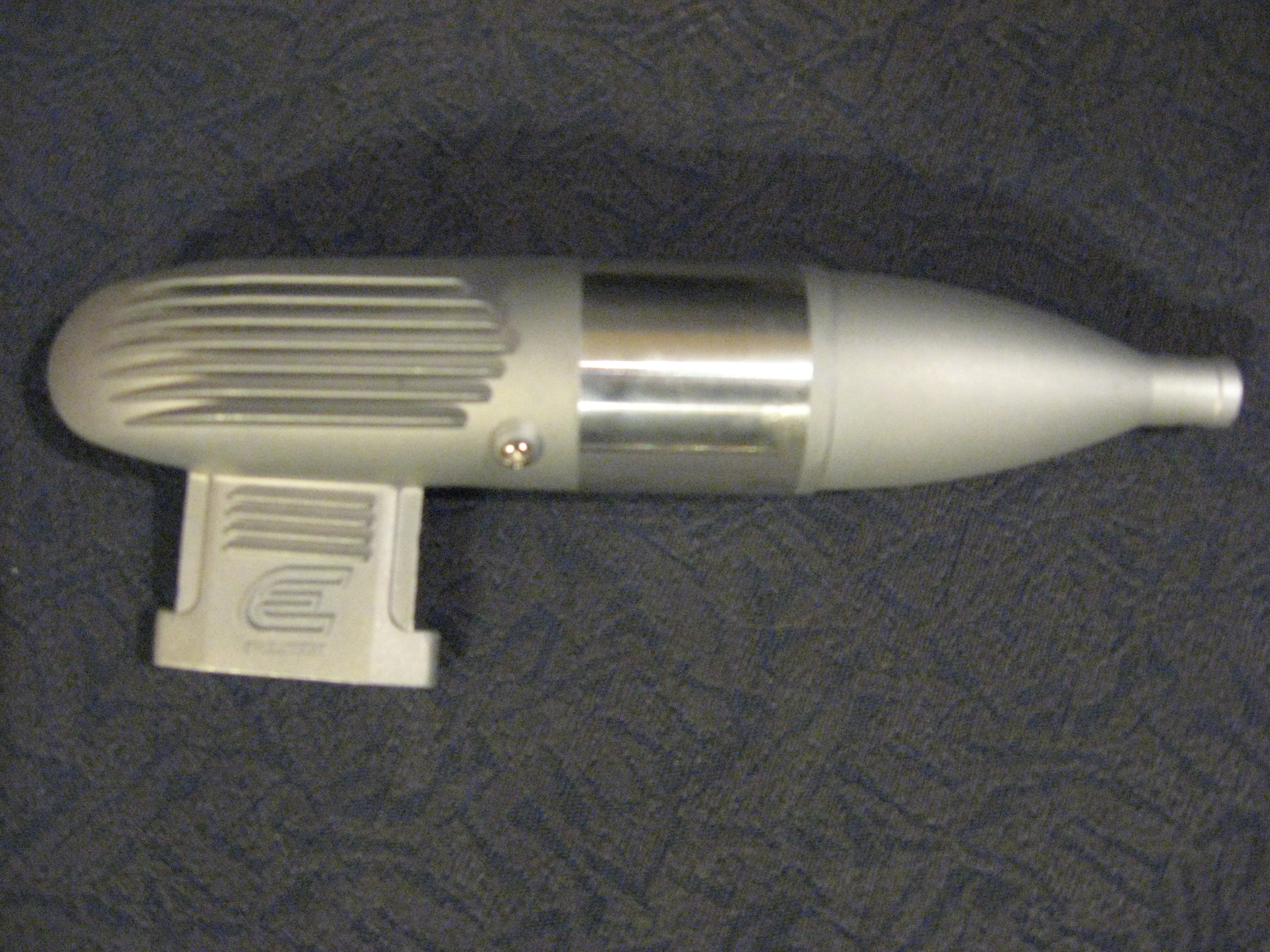

Just got my 15cc gas engine from Evolution and they have redesigned the muffler to hopefully fix all the leaking problems it has been having.
It is a one piece design with no seams that I can see.
The pressure port for the gas tank has been sealed and there is not a bolt running through the muffler.
Exhaust is now straight out the back.

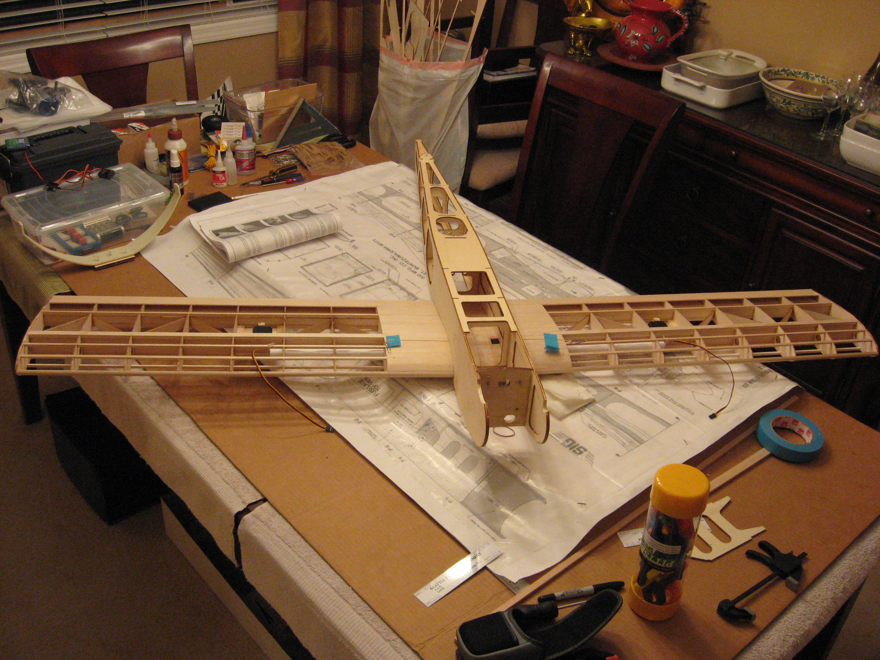

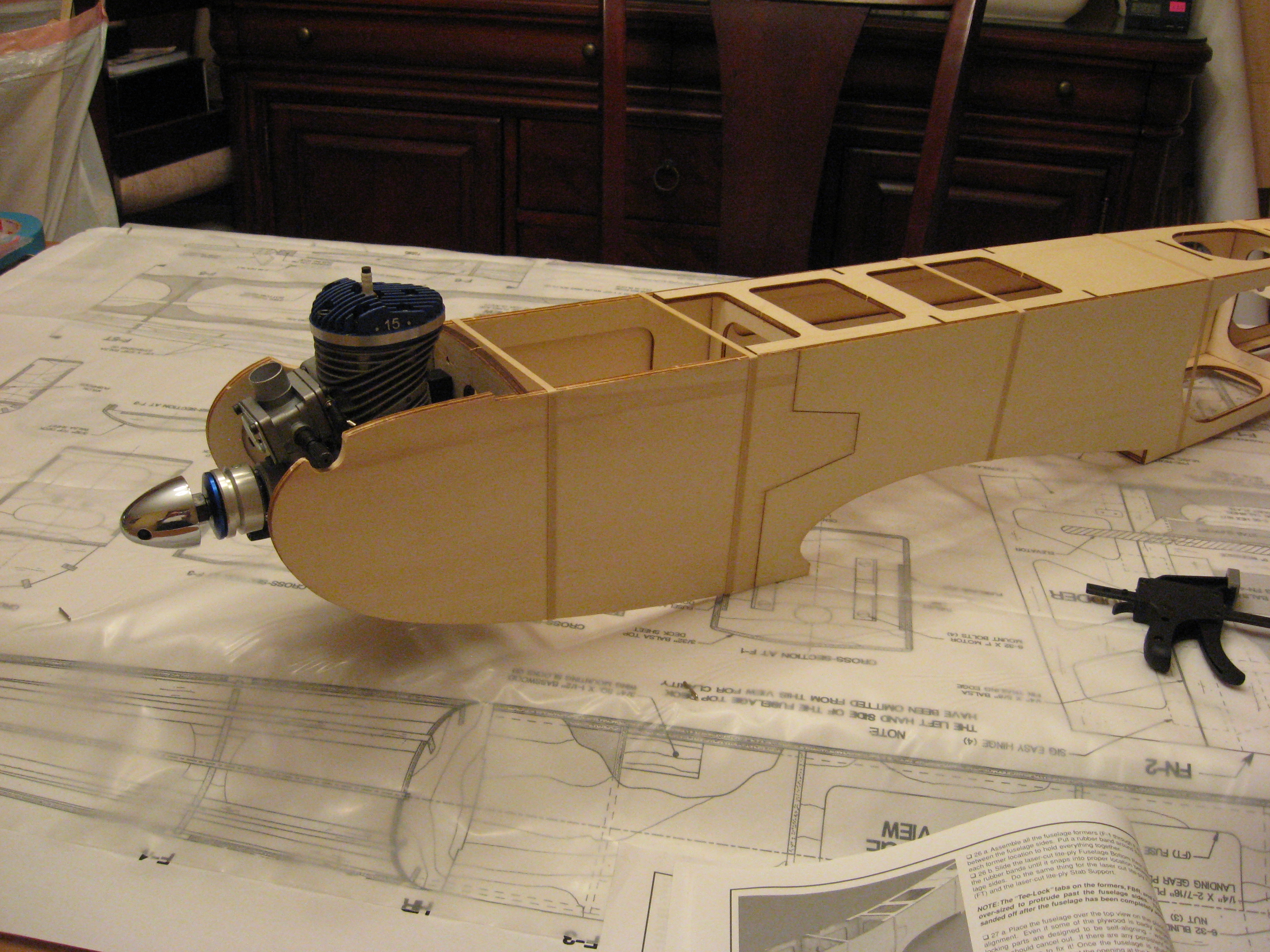

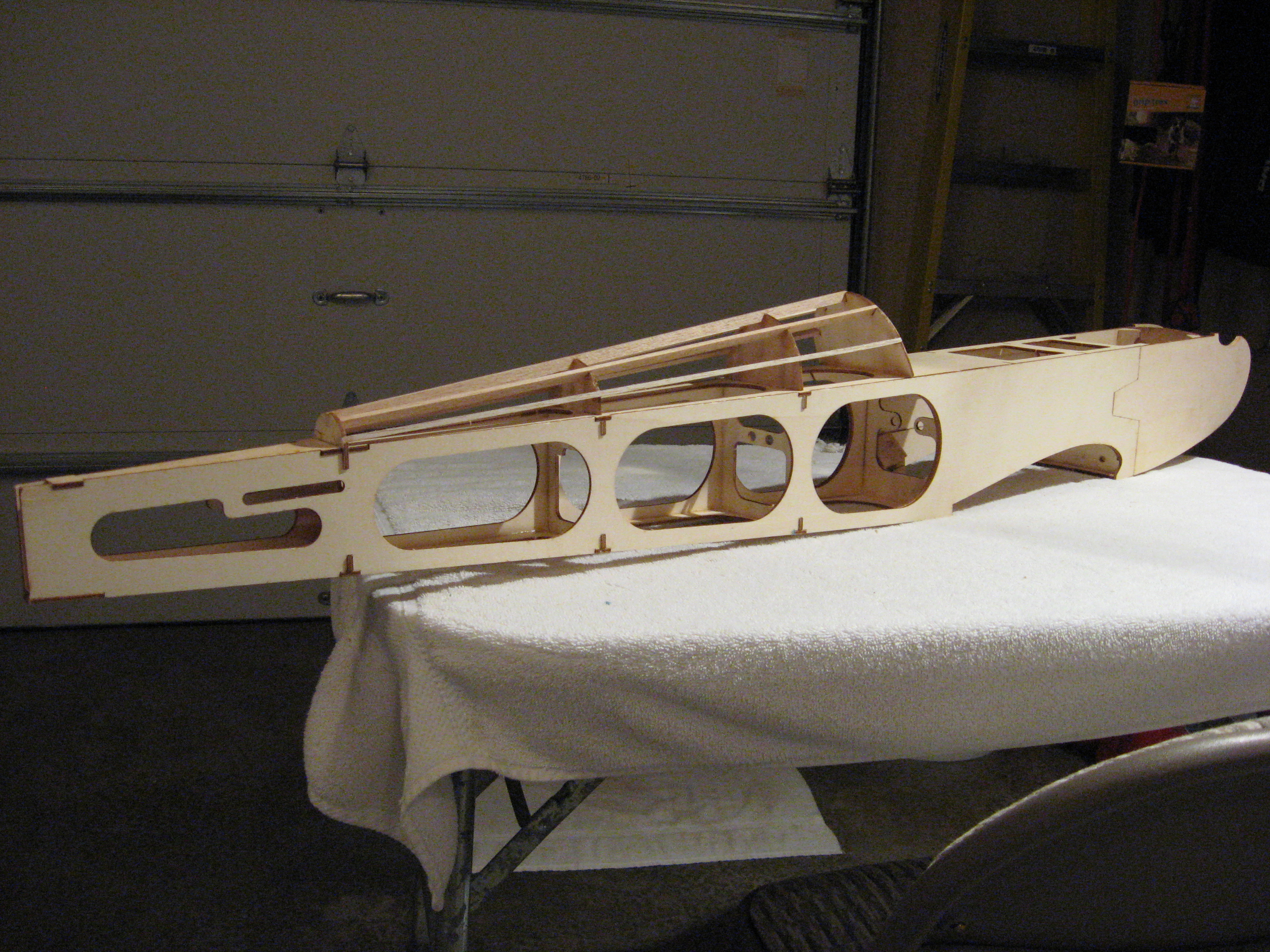

Have not fired it up yet, but from everything I have heard and researched, it should be a great engine.
The only knock I had heard was that the muffler would come loose all the time and now that they have redesigned it, that should not happen.
I am building the airplane it is going into right now. Sig 4 Star 60

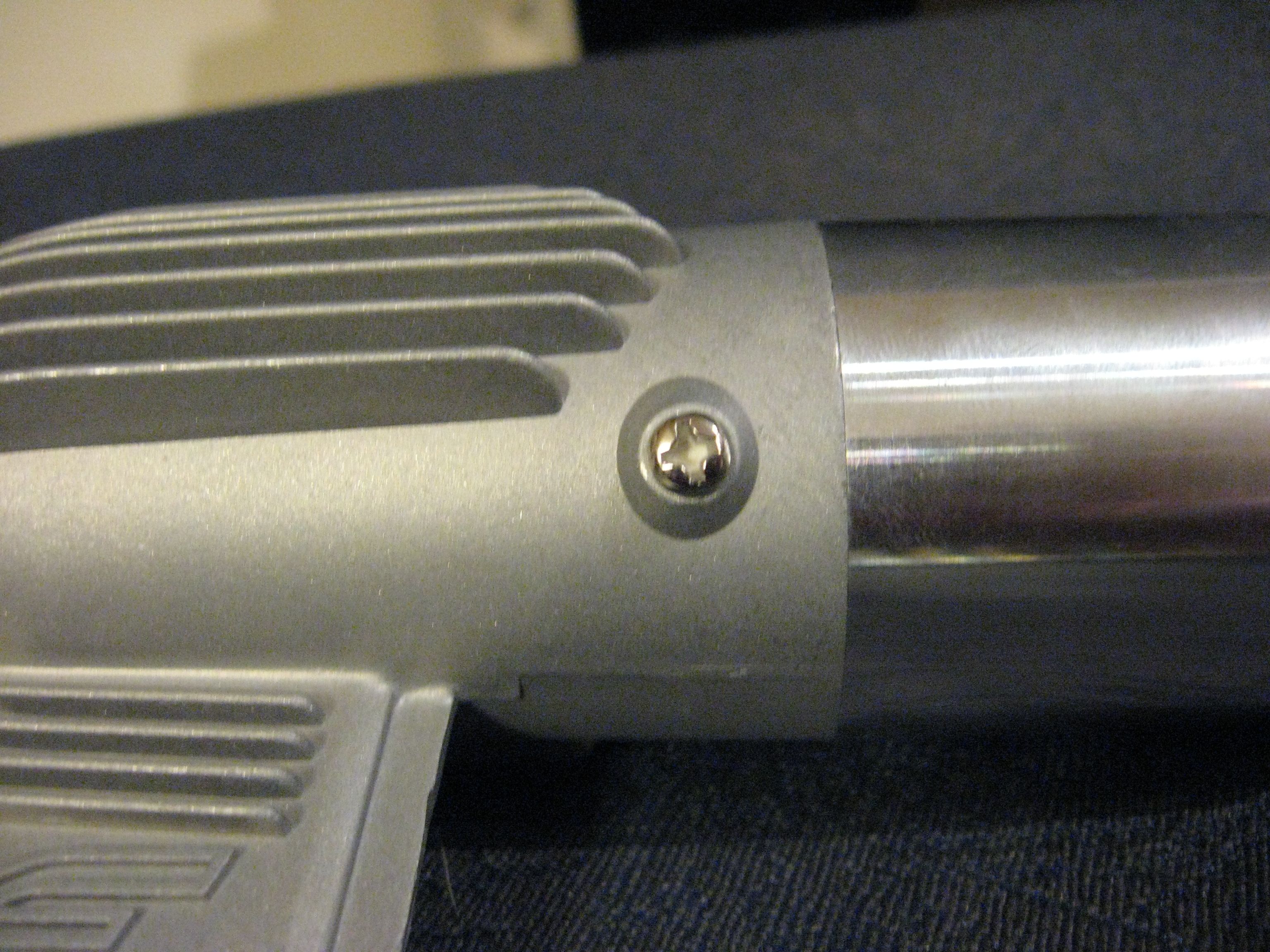

Mine leaks like a sieve!
The 15GX2 gas (pumped carb) one piece muffler is leaking from half way down the muffler. I cannot see how to dissemble.
The manual shows a through bolt with a nut etc but my muffler looks to be a single peace with no nuts holding it together.
It is leaking from under the metal band half way down the muffler, the engine mount has sealed really nicely, so the gunk is not coming from there.
Do you know how to fix the leak? I am assuming I should be able take the muffler apart and seal, but I cannot see how to dissemble.

Bones,
That is diffinitly a one piece muffler that looks like it had been press fitted together. I do not think you can take it apart. I would call Horizon Hobby and talk to their tech support and they my just send you another muffler. The muffler issue is why I choose to buy a OS GT15 gas engine. With the specials Tower is running right now I got it for 299.00 delivered. I have an NGH GT17 and have been fighting muffler issues with it for 6 months
and did not want another engine that had these issues. Good luck with it and I think Horizon can help you. They have really good customer service.

Nice looking 4 Star 60. That plane is a great fly plane. I have the 4 star 120 with a DLE 20 and it is my beat flying plane. The Evolution 15GX should be a very good fit for your 4 Star 60
and did not want another engine that had these issues. Good luck with it and I think Horizon can help you. They have really good customer service.Jeff,

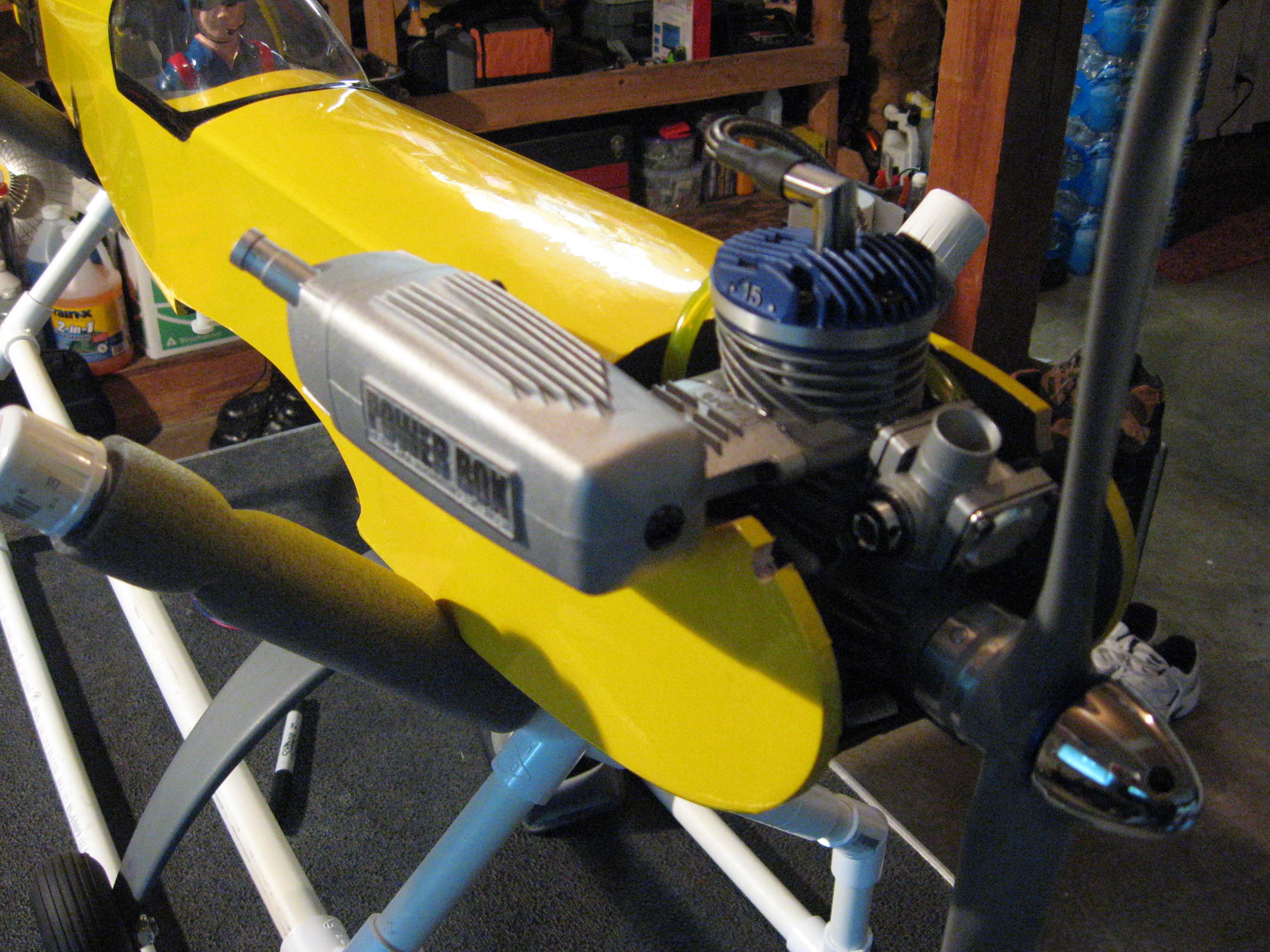

I'm dissapointed to hear that the new muffler is leaking at the joints. I highly recomend the OS powerbox muffler that comes with the OS GT 15 as a replacement on the Evo 15. Looks and sounds good on the Evo/ 15.
Pete
Fwiw, it's not possible to cast a muffler like that in one piece
Pete

Well...so much for the "re-designed" muffler.............

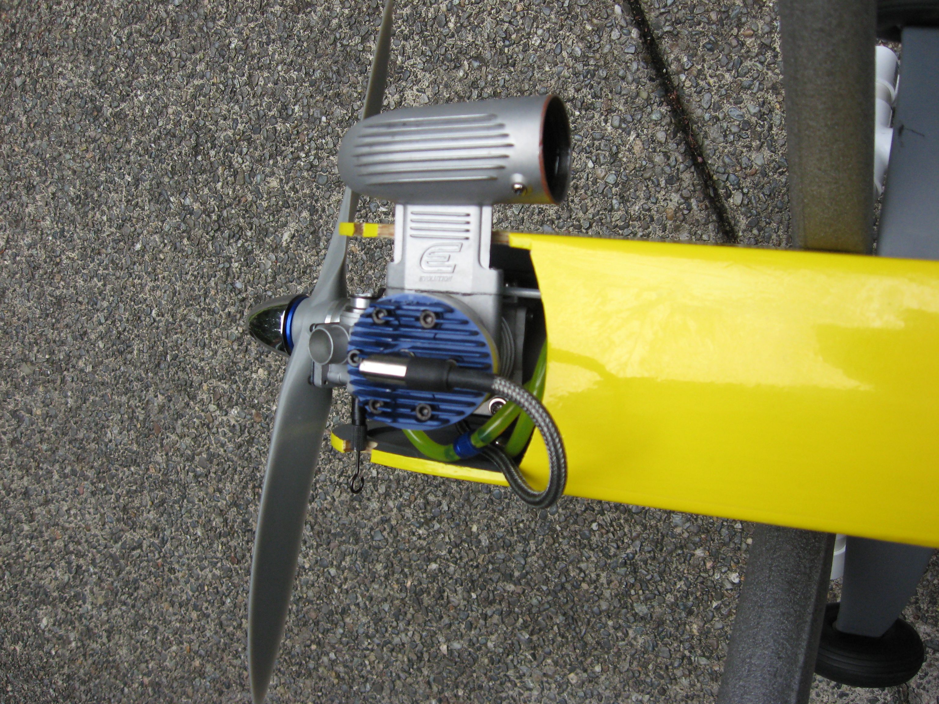

Was flying my newly built Sig 4 Star 60 breaking in the Evolution 15GX2 engine when I saw something fall off and the engine got very loud all of the sudden.
I thought, oh great! there it goes, I thought my plane was going to fall out of the sky.
Luckily the engine continued to run so I could land it in one piece.
The one piece muffler came apart at the shiny metal band.
Just ordered the OS E-4040 muffler.
Prior to coming apart, the muffler leaked like a sieve at the metal band.
Ouch!!!!
Well, now it truly is a one piece muffler Jeff!
I don't know what they're using to bond the three separate pieces together, but the high temperatures, together with the oil in the exhaust are tough on whatever they used to "glue" the pieces together.
The OS muffler does use a through bolt, BUT, since the two halves of the muffler cannot rotate, due to the sorta square cross section of the muffler. I've been using the OS muffler for two years now, and have never had to tighten the through bolt
Y'know, since you have the pumped version, you might not really see any change in needle settings with the new muffler, since you're not using muffler pressure.
Let us know how you like the new muffler!
