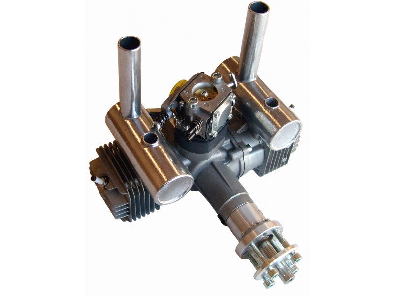

Go with the VVRC 40 twin 1/4-32 and you will not be disappointed. I have one in an RedwingRC 30cc MXS-R and one in a Hangar 9 Valiant 30CC. I run them on 100LL and 35-1 oil.
Get one before they are gone they sell out fast.
http://www.valleyviewrc.com/estore/vvrc-40cc-gas-engine-w-1-4x32.html

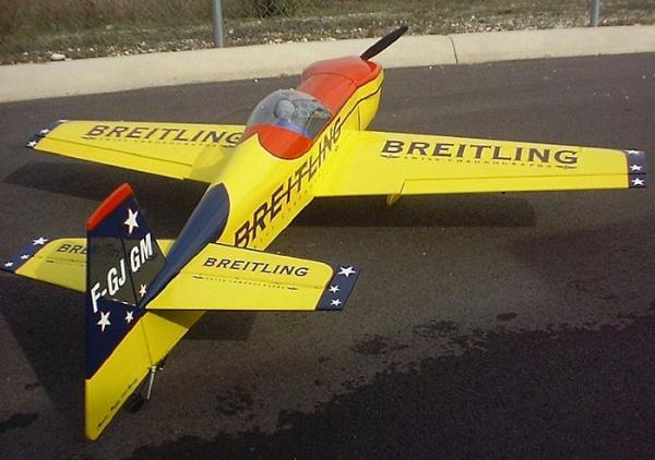

The Midwest 27% 80"Cap 232 is a sweet flying airplane for sure, I built and flew two of them over the years, one had a Moki 1.8 on the nose @ 16 lbs. the other a BME 44cc single @ 18 lbs. A buddy of mine built one that weighed in at 21 lbs. with a G-62 on the nose that also flew very well. None of these were 3-D airplanes but again flew very well. Realistically unless you place that airplane on a diet during the build they tend to come in a little on the heavy side by today's standards, but honestly an airplane doesn't need to be 3-D capable to be a great flying airplane. Here is a picture of my very old Midwest 80" Cap with the 44cc engine.
Bob

Pretty plane Bob. Caps look great in yellow. The only major change I have made so far was I swapped out the kit wood for contest balsa for all the sheeting. On average it was about half the weight of what came in the kit. The wing weighs 2lbs total, the body just under 3. thats without covering and I haven't finished the nose of the plane on account that I haven't decided on power plant.
What can you tell me about the challenges getting the plane to balance with a BME 44 in the nose? The G62?

As I recall I moved the rudder and elevator servos into the tail and the battery pack aft as well. The Cap with the G-62 actually flew spectacular IMO, and to be honest, if I ever get my hands on another kit of the Midwest 80" Cap 232 I will place it on an extreme diet and place a DA-50R in on the nose.
Bob
