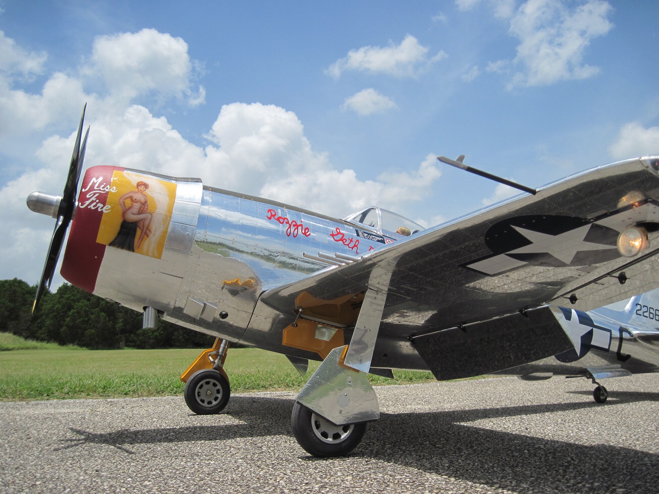

Fired mine up the other day for the first time in over a year after break in, started right up, restarts are easy and after tuning runs like a top, maiden today.
