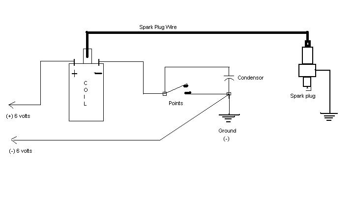

This has nothing to do with RC gas engines but I have a 1965 Tecumseh lawn mower engine with no flywheel.
I was wondering if I can convert the magneto ignition to a 12 volt automobile coil and a 12 volt battery. I would be using the points that came on the engine to energize the coil.
I have every thing that I need except the spark plug wire which goes from the spark plug to the coil. It seems like this would work.
What do you think?

Sure, it will work. Wire positive (+) power to the positive side of the coil, negative side of the coil to the connection on the points. You also need a condensor hooked to either the points or the coil. Connect the wire from the condensor to the points connection or the negative side of the coil, and ground the body of the condensor.
Cars with point ignition systems were set up to start on 12 volts, and run on about 6 volts. This was done in various ways. Some had a resistor in the coil to cut down the voltage, (GM), some had a resistor wire going to the coil (Ford), and some had a separate ballast resistor mounted somewhere, usually on the firewall. (Dodge) Then the system was wired up so that when the engine was cranking to start, the coil got 12 volts, and when the engine was running, it only got about 6 volts. If you run 12 volts to the ignition system full time, it will burn up the points fairly quickly. What I would do is just run a 6 volt battery because it will start just fine. (You won't for example, be starting it with a damp ignition system in freezing winter conditions with dirty old spark plugs like you might in a car.) However, be sure to get a coil that does not have a built in resistor. One from an older Chrysler product, (Dodge, Plymouth) would be my choice. (Try something from around 1966 or 1968.)
Well, that was the long answer, but I hope it helps.
AV8TOR

Default Points Ignition diagram
Here ya go:
Can you tell I had some time to pass??
AV8TOR

Actually, the resistor wire is there to cut down the current the points are switching and keep them from burning up. And they will burn up in fairly short order if you run a full 12 volts to them. (ask me how I know...) The coil can take the voltage, it's the points that are sensitive. That is also why the condensor is in the circuit. It draws the current away from the points to prevent arcing when they open, and once again, getting burnt. With CDI ignition, the coil is often charged on the primary side with several hundred volts.

I converted to a 12 volt battery, points, capacitor, and 12 volt coil. I used the original capacitor that was used with the magneto and the original points. I checked the ignition with a 12 volt timing light this morning and it is firing. I used an old 12 VW Beetle coil I had. VW must use a resistor in their coils as the primary circuit resistance is over 5 Ohms. VW 6 volt and 12 volt coils don't use a external resistor according to their schematics. The 12 volt wire on VW's goes from a fuse directly to the + terminal on coil. The battery I am using is a Tower Hobbies 12 volt 7 ah lead acid torqmaster lc. I have been using that battery for 3 years for starting my electric start Ariens walk behind 21 inch lawn mower.
Thanks for your help and the other ones that have replied.

The VW beetles used two types of coils, one with built in resistance, and one without. Generally, the Bosch blue coils had resistance and the Bosch red coils did not, but you were never sure unless you measured them because the coils were made in several different countries and just named "Bosch". The black VW coils could only be determined if they had resistance by measuring.
Glad it worked out for you!
