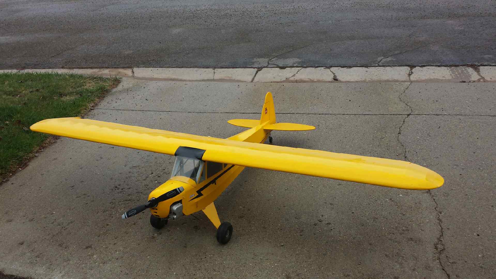

Here are two pics of the cub. I will get close ups of the engine tomorrow

How about pictures of the engine? We can't really tell much about the engine from looking at photos of the airplane .... other than it is a piston ported engine. Also, what size is that prop?
The photos look like it might be a Great Planes CUB.

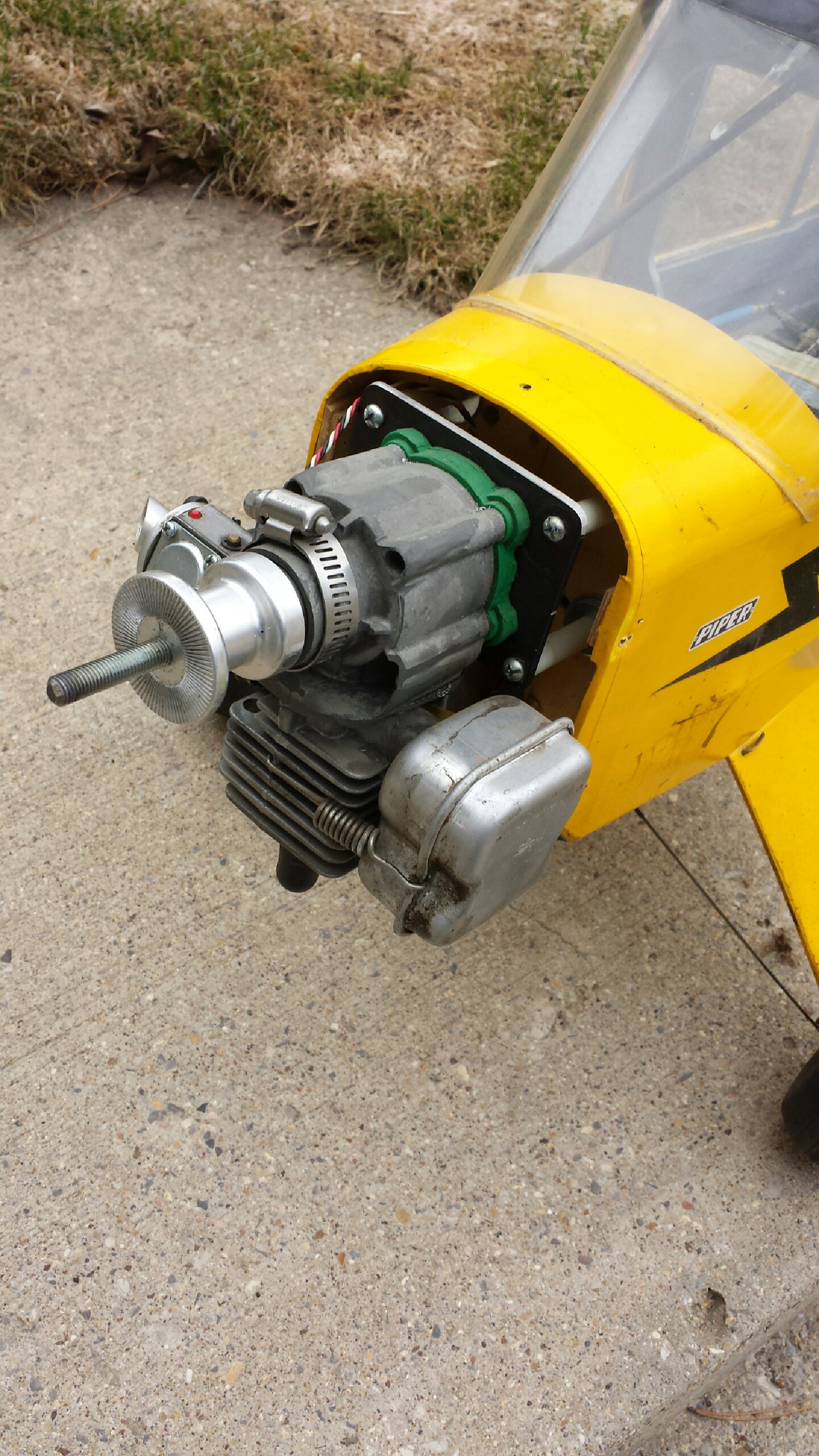

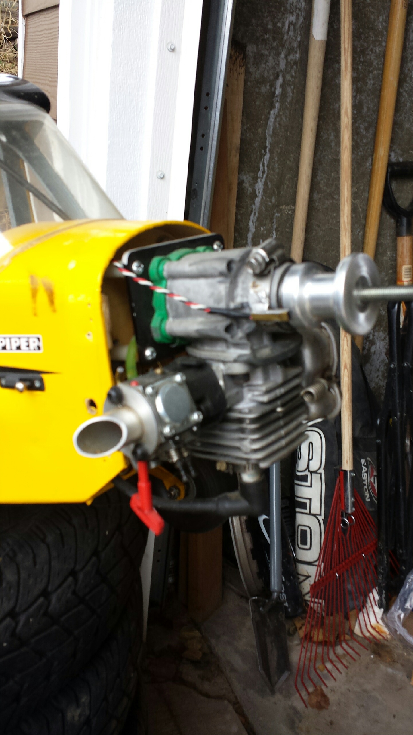

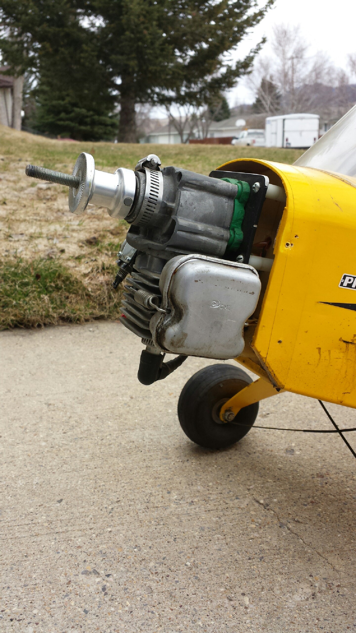

The prop is 18x8. Here are some pics of the engine.

looks like a weed wacker engine probably somewhere in the 25 to 32 cc range. If you cant get around 7000 rpms with the 18x8 prop try a 16x8
Old 03-15-2015 | 11:32 AM
av8tor1977's Avatar
Joined: May 2003
Posts: 7,245
Received 6 Likes on 5 Posts
From: Tucson, AZ
Looks like a "Weedeater" brand engine. In my experience they are a very cheaply made engine that is low on power. One thing you can do to help is pry apart that muffler, and remove any and all baffling or noise suppressant materials inside. Then provide one 5/8" or larger tube outlet, or two tube outlets of about 1/2" diameter. Then try a 16 x 8 prop as mentioned. That engine will never do well with an 18" prop.
If you want to go a step farther, look into the carb throat and see what number is cast into the throat. Then we can tell you if a larger carb would help as well.
Of course, all this is assuming the engine is in good shape to begin with. I have seen engines that actually ran quite well gain 800 rpms (which is a lot of power!) when the worn piston ring was replaced....

As av8tor1977 said it is a "weedeater" brand, most a likely 25cc engine.
As stock they are not very strong but they are very light and can be improved. As mentioned the easiest way to improve is by:
1. Changing the muffler, or at least remove any internal baffles and increase the size of the stinger (outlet).
2. Changing the carburettor, the standard venturi size is often around 8mm (size 20), the correct size is 11mm (size 28), but size 24 (9.5mm) and 32 (12.7mm) will also work.
3. Suitable props for this airplane (floater type) and engine are 16x6 (fastest - around 8000 RPM), 17x6 or 16x8, even an 18x6 will do better than an 18x8, but it will be more responsive with the smaller props.
4. If you are a bit technically minded you can also do some ports work, in standard form this engine is very mildly ported.
