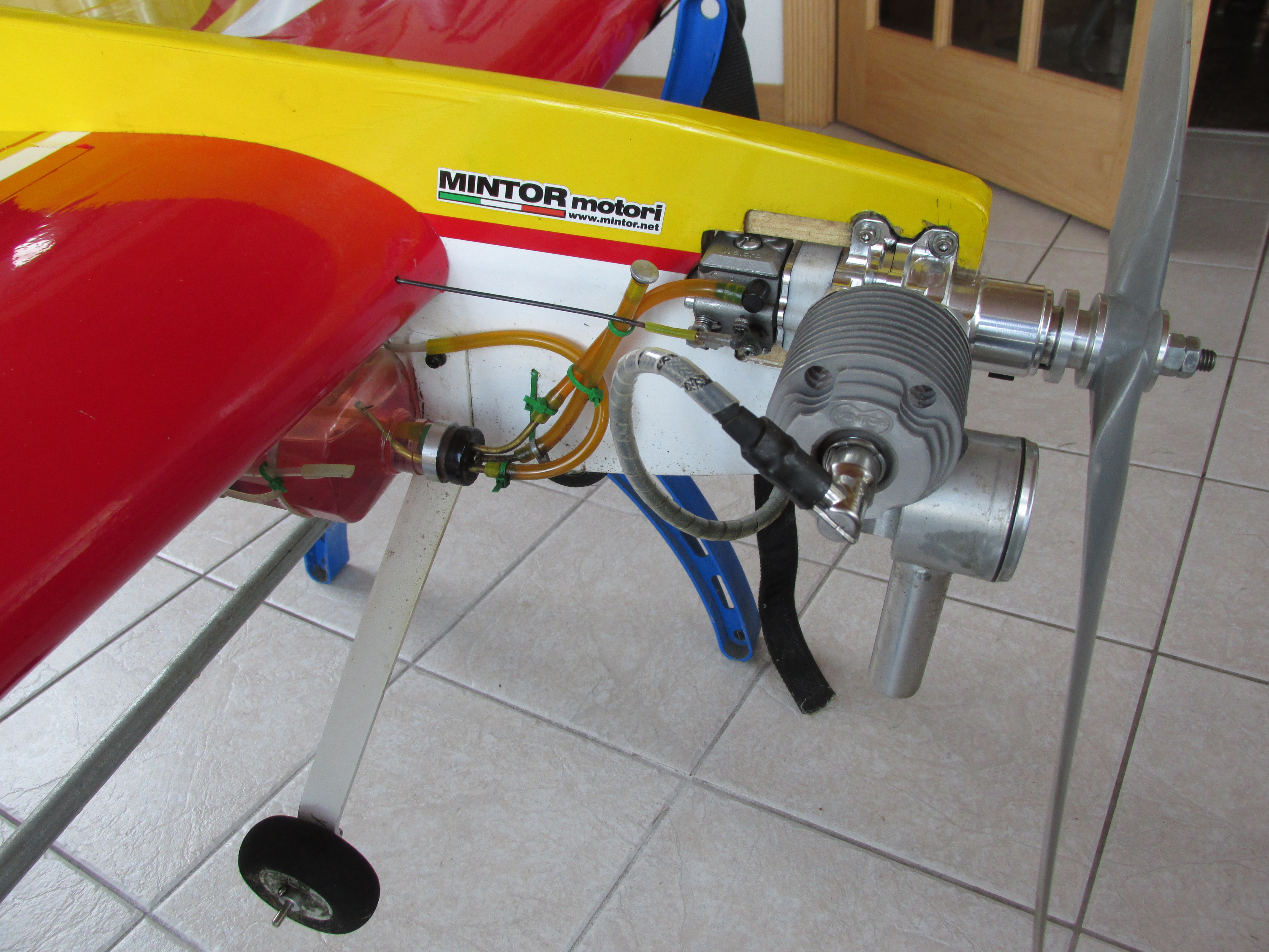

I use a ring made from aluminum around the neck of fuel tank. Use a Dubro stopper for gas & tighten the screw good. The ring will prevent the tank neck from splitting. Been working 3 years now. Capt,n
