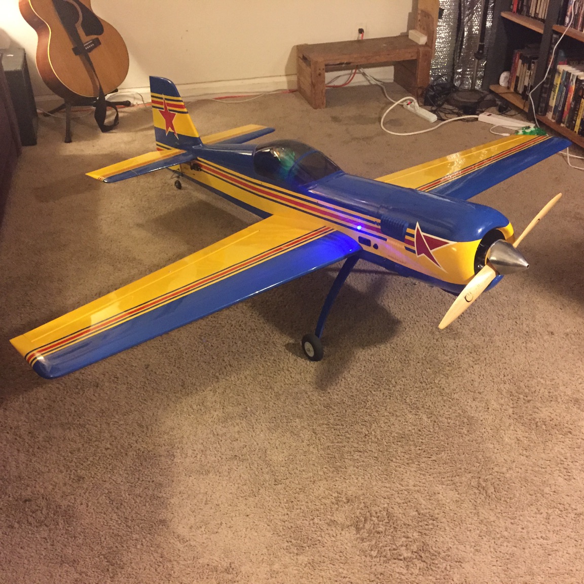

I have a used DLE30 - have owned it for over a year and am just now starting to run it. The problem is it is very hard to start - it occasionally backfires and sometimes does not start at all. I have re-built the carb, re-set the needle setting to default, and still have the problems (my arm was sore last week from so much prop flipping!) With the plug cap off and the plug inserted I'm getting spark, just fine. When I DO get it running it runs great at mid-high RPM's - but when I bring it down to idle it seems to idle fine for 10 seconds and then dies and then I can't get it restarted. But something that ahicks (HEY, Ahicks!) just said tells me that there may be a problem with the boot insulation (though I don't SEE any crack in it.) So I'm now thinking it's either something electrical \ no spark, or the reed valves are not seating flat. Last night I rigged up a completely different electrical system on this plane \ engine (from new spark plug, Halls sensor, EI, IBEC, power switch, and battery) and will try starting it tonight when I get home. If it's not that then I'm guessing it's the reed valve. Question - would the exact location of the Hall sensor make much of a difference? I have it positioned in the middle of the pre-drilled holes in the crankcase, so I'd think that should be good. Any advice is welcome. I GOTTA get this engine running! (I will post my findings tomorrow) (btw - I also have a DLE 20, 30, and 35 - all running)
Thanks.

So the engine runs great with the new electronics. (and the Halls sensor was set at 28 deg, btw). But the problem is it takes forever to pull fuel when I'm trying to flip-start it. So I looked at everything again - the carb, the tank, the lines. Now, with choke closed and throttle WOT, it won't pull at all (when I flip the prop by hand). With my other DLE 30 and 35 it usually takes 10 flips the first time for a "pop", then another 5 with the choke open to start. Now - with this 30 - it's not pulling at ALL when I flip the prop by hand. I then tried a starting and 22 volts of power turning that spinner QUITE fast, and it finally pulled fuel, and quickly, to the carb. A few more hand flips and it started, and seems to be running fine now (both needles now set to about 1.5 turns). But I should not have to rely on a starter motor. So - question - why am I not pulling fuel normally? Could the carb passages be dirty? If so, how do I clean those? Could the metering level not be high enough? (though I measured it with my Walbro gauge, and it looks correct).

I tested using a tank from another gasser and the DLE30 pulled fuel fine. So I installed a new tank, stopper, pipes, tubing, and it's now pulling normally. Will test again tonight, but do not anticipate problems.

With the new tank and plumbing the DLE30 is now drawing gas normally, and the engine is running perfectly. Sounds like a beast! Ready to maiden this CG Sukhoi this weekend!
