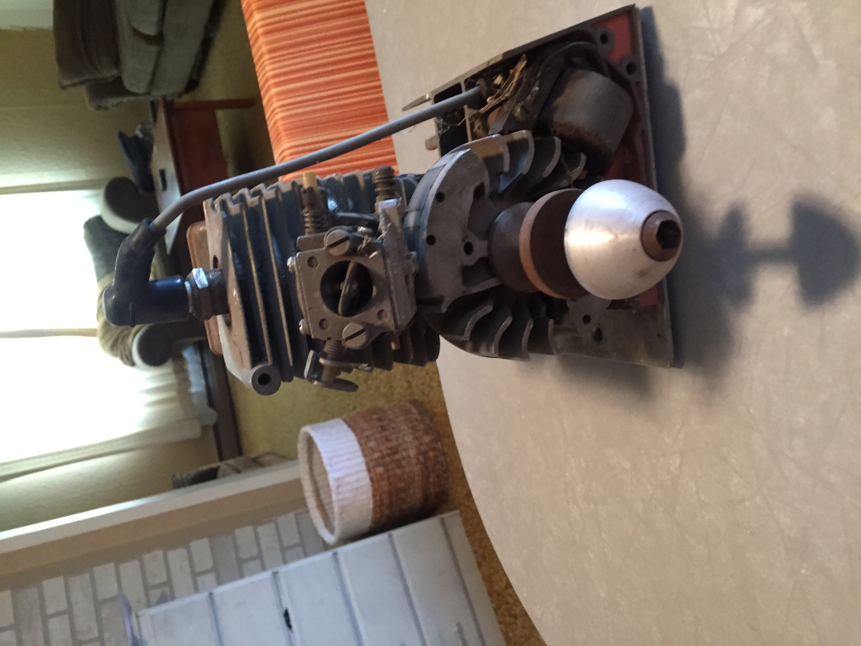

Angry Help what engine????
I got two of these but dont have any clue what they are.

I have no idea what engine that is. It has a very unusual layout with the carb on the front and the mount on the bottom.

WOW, totally no Idea? Worked on lots of small "weed-wackers", etc. No clue!

My SWAG is that they are for something like a Billy Goat, where the shaft turns a blower wheel and the whole mess is on wheels. What displacement does it seem to be? Are there any markings at all
on it? Is that a clutch on the shaft opposite the prop hub? What brand and number is the carb? More importantly than what they are, is do they run and with what size prop and what rpm? Good luck, let us now if you find out more.

The low carb position suggests case vs piston port induction. Are there reeds under the carb on the carb mount?

The cylinder says mahle on one side and then the other says 38zd15. Walbro carb. And im new in this so i wouldnt know the engine size to well

it has a 38mm bore

It looks rather heavy and bulky to be a viable model airplane engine?

Its from a stihl 015

Though the Stihl 015 makes good power for its displacement . . .
You are going to need to shed half its weight as shown to use it as a airplane engine.
All the extra material in the bottom bearing cap needs to be removed.
The prop hub needs to be changed from steel to aluminum.
Possibly change it over to RCEXL style ignition to save weight.
