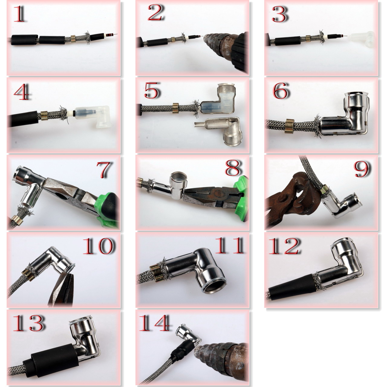

Need to replace the Cap on the EI that connects directly to the spark plug on a DLE 30... I have the kit to install but am not sure how to proceed... got the parts from Valley View.... I noticed that there is a transistor in the replacement kit... I also have two new springs for the DLE 30... Does anyone have a document that shows how to replace this spark plug cap...? or any suggestions on the installation.... Thanks...

From: Auburn, GA
Milton
Name:	CM6 Caps replacement-2.jpg

Is he resistor soldered to the internal wire or just pushed in?
Just pushed in.

OK, now could someone show how to install the 1/4" plug cap to the plug wire? WHERE is it soldered. There's solder in the kit.
