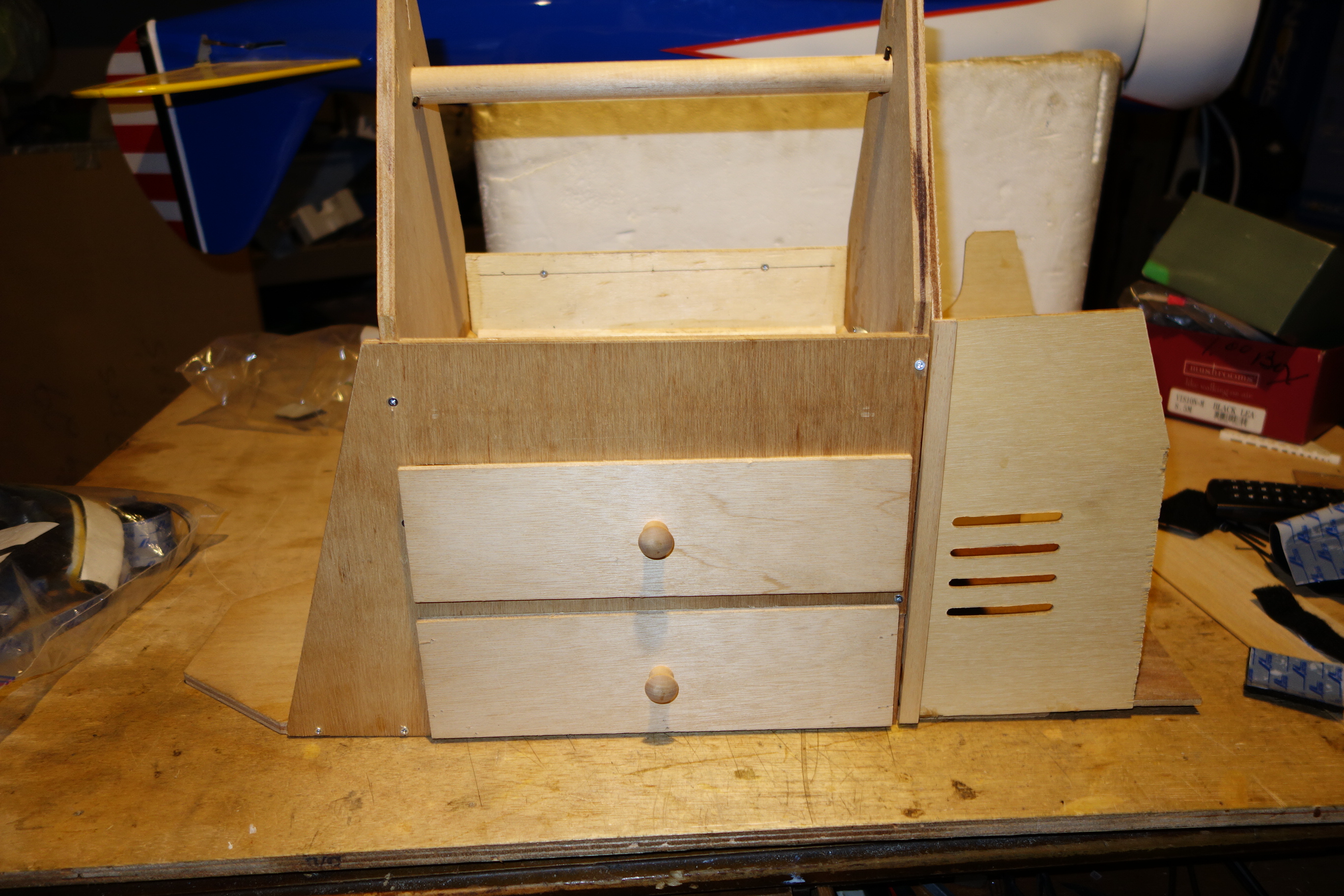

as I am getting into gas, I thought I would have a flight box for Gas. fount a Great Planes kit at a second hand store and built it.
I am ready to finish it, but don't know the best way to fuel proof it. I would like a wood look, if possible.
all I know is it has to be able to handle gas.

My first and only flight box has been a Goldberg Super Tote that I put together almost 40 years ago. I fly glow and finished mine with a walnut toned oil stain rubbed into the plywood. Still looks like a piece of furniture after all this time. I've also stripped wood props by sanding them, and finished them in a similar way. Using an oil stain enables a simple touch up later if needed.

Any of the oil based Polyurethane finishes such as Minwax, Varthane or Deftthane just to mention a few are very durable over time. Use a compatible stain to get the look you are wanting or just apply directly to the ply for a natural look.

I will go with the stain and sealer, that sounds good.

Are you planning on spilling gas all over it Yes 2 to 3 coats of oil base poly will do it. I keep my gas on a T shaped carrier I made from scrap plywood and painted with Rustoleum industrial spray paint. It also also carries my smoke oil and I power the fuel pump with a 12v lipo. Nice and light and easy to handle.

Personally, I would use Dupli-Color engine enamel. The one with ceramic in it. Dries fast and is definitely fuel proof after a couple of days. You could also use their primer/surfacer to fill the grain of the wood. Do several coats, sanding between each one, then shoot it with the enamel. Clear coat is available too, but not necessary. The enamel will buff to a really nice gloss without it. If you shoot a careful wet coat, you won't even need to buff. I recently used these products to do a custom paint job on my brother's motorcycle gas tank, side covers, etc., and was really pleased with them.
