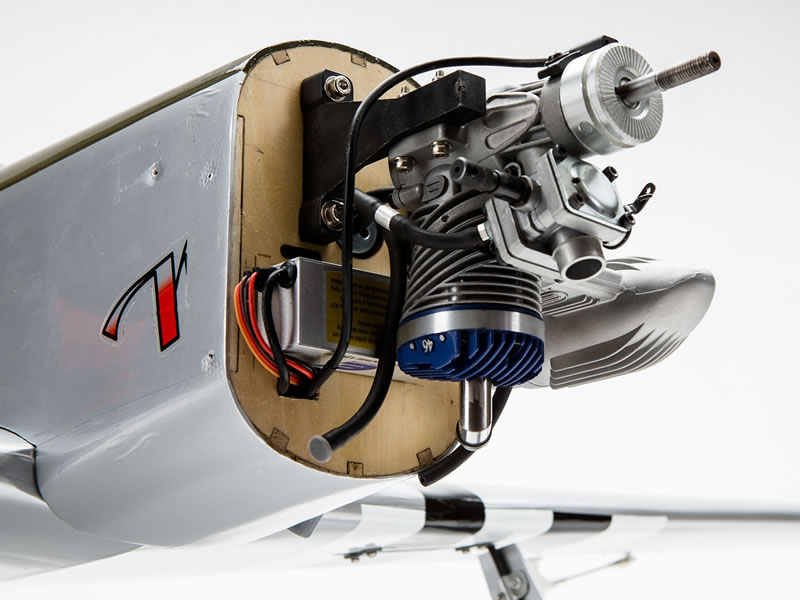

Well I wonder if Horizon will release this engine in the States?
Watching one over the weekend in their BNF Mustang and it sure is a good runner! I wish I could have gotten a tach on it because it is swinging that factory 12x6 really well!
Anyone tach theirs? How are you liking it?

The 10cc engine with the new carb (latest production) is virtually the same engine. New carb makes it a winner in my book. Swinging APC 13x6 at 10.5k makes it a pretty good performer. 12x6 was over 13k as I remember....

Yes they are quite close - .46ci .59ci. - I do see the 8cc listed as pending on Horizons site - I am curious which is lighter and how close the performance is. They are super cool little engines!

I suppose when it gets right down to it, that your intended purpose/project size will have a bearing on which engine might work out better for your purposes. To that end, been playing with the 10 for a while now, and have had it in several different planes. I can tell you a good target for the 10cc engine with decent sport performance in mind will be .45 size plane around 6lbs and 650 sq in wing area.
Not sure how much smaller you would have to go with the 8cc engine to get duplicate performance.
I can tell you that both engines use the same carb.

Yeah those are the basic spec's on the BNF 8cc P-51 as well - Plenty of power and radars over 70 mph!
So it's got to be spinning that 12x6 at least 12k RPM flat out.

Ran the little guy on it's first tank today!
Wow she runs great! Idles 2200ish very reliably and it peaks the stock 12x6 prop at 9100/9200 right now. Had to go 1.5 turns on on the low for reliable idle/transition and top end was close out of the box.
Sweet little engine!

4 flights on her now - Idle a solid and steady 1800 rpm and max is up to 9700 rpm on the stock 12x6 Evo prop.
Great engine!
