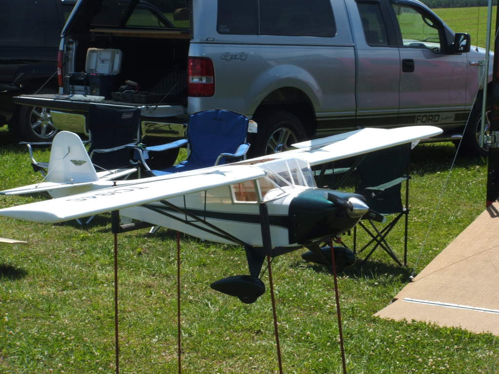

Is this bird heavier than the similar sized Ace Taylorcraft ?
The Ace Taylorcraft flies easily on a G-26. I had one that flew on a 1.20 four stroke, too.
