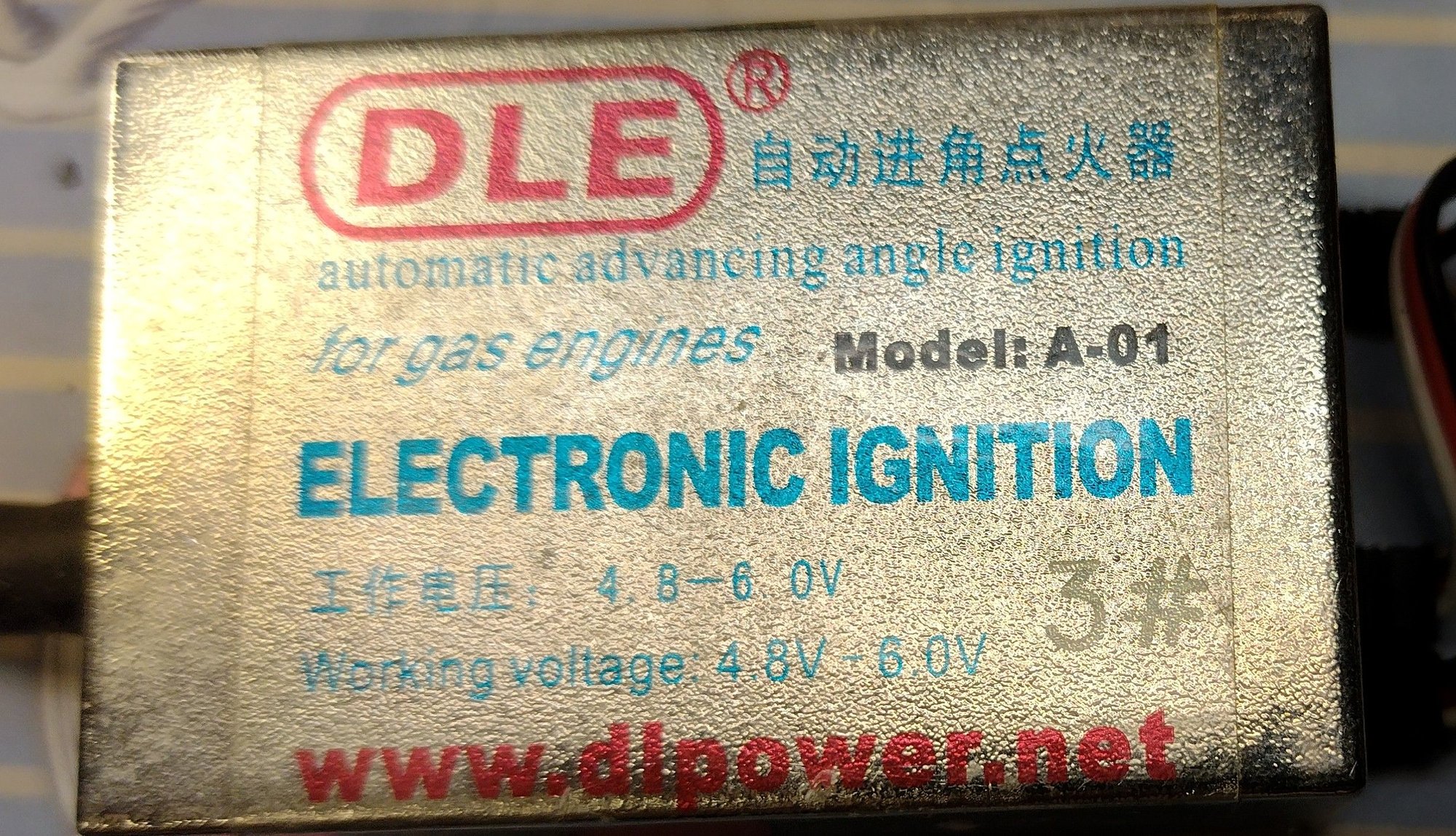

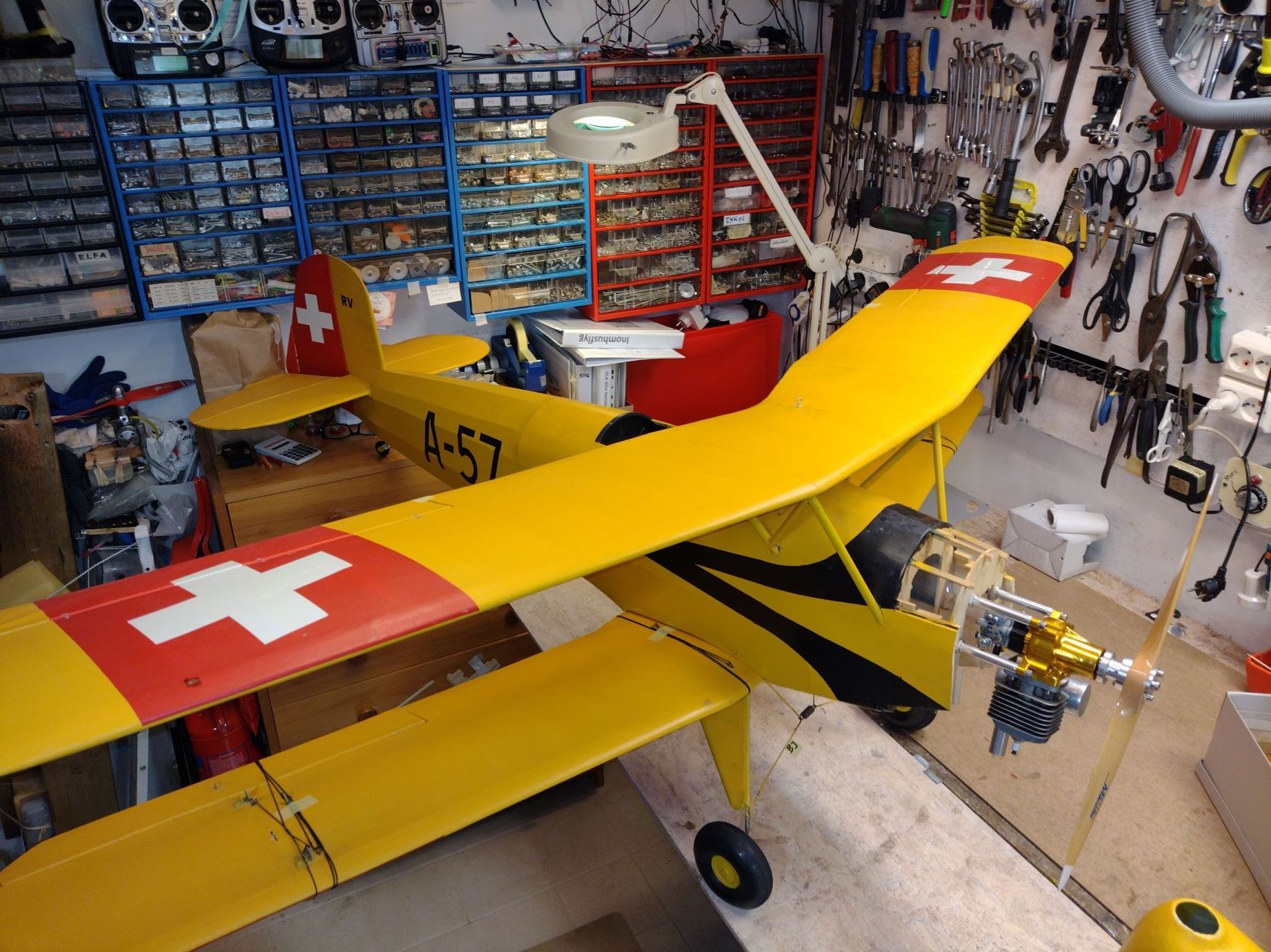

I am currently building/renovating my first "gasser", a Bucker Jungmann scratch built 1/4 scale and will use a DLA 32cc gas engine . The CDI module (from a DLE engine) states that battery voltage should be 4.8-6.0V which is not easily achieved in practice.
A 4 cell NiMH could certainly fall below 4.8V and a newly charged 5 cell NiMH will certainly start off well above 6.0V. Without load a 5 cell NiMH will initially give
over 7V.....!!
How do you manage this guys..??!?? Please advice - thank you.!

That is ZERO problem: This CDI is indicated to work from 4,8 to 6 volt, NOMINAL.
That means that it will work on a 4 cell NiMH, OR a 4 cell 1,5V dry cell pack.
These ignitions will without issues run on a 4 cell NiMH, and until empty. I have seen these to work without issues down to below 4V actual voltage.
The early RcExl were nominated that, and 99% sure this is a rebranded RcExl.
The later versions, that had "6V till XX volt" on them (there were varying versions over the years) indeed started to malfunction below 5,5 volt actual, but these ones go much lower.
A modern 2000 mAh four cell AA pack, like Sanyo Eneloop, will easily power that ignition for about 4 hours nonstop operation.
I know because I still have a few of these old ones in use, and those are my GoTo packs...
I usually feed these ignitions straight from the receiver busbar, never had any interference (using 2,4 GHz).

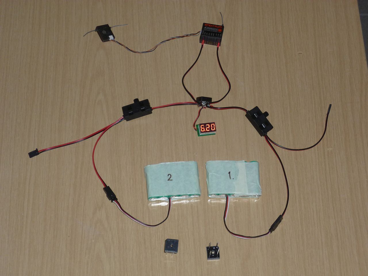

1) I will go with one 4S 2500mAh NiMH to feed the CDI separately via the kill switch.
2) Rx, servos, gyro...etc will be fed by two 5S 2500mAh NiMH packs connected via a diode bridge as shown in attachments.
Further I will keep 1) and 2) above as far apart as is practically possible to minimize Rf interference.! As mounted right now the CDI module and the Rx antennas are 14 inches apart.
Being cautious is always a good thing of course, but to be completely honest, I have been using these ignitions, for about 14 years now in total, and in the time of 35 MHz, there was still a bit of interference every now and then (using PCM, separate circuits and the antenna as far away from the ignition was a must back then), but since 2.4 GHz, I have been feeding the ignition from the same battery, and in some cases the ignition and RX/antennas were less than 8" separate (simply because there was no room... Try fitting an ignition and RX in a Robbe Charter or a Calmato and you will know what I mean), never had an issue with that, EVER.
These ignitions are pretty good, and the nowadays 2.4 GHz receivers are downright amazing with their interference rejection.
If your plane allows, then there is nothing wrong with "distancing", but if it doesn't, then also don't worry about it too much.

Again - thanks brutus for sharing your experience. Since I am an 81 year old "newbie" to gassers in airplanes I am probably a bit overcautios here. At least that gives me some extra "peace of mind" when the "maiden" flight of the resurrected BJ takes place.
