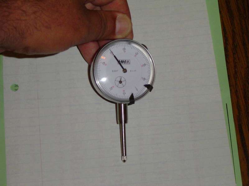

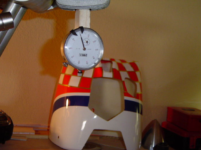

Here's what i did, bought this tool for 15.00 and made a sleeve for it to slide into then screwed it into the clyinder head. and rotated the piston till i found T.D.C. WA LA. T.D.C
