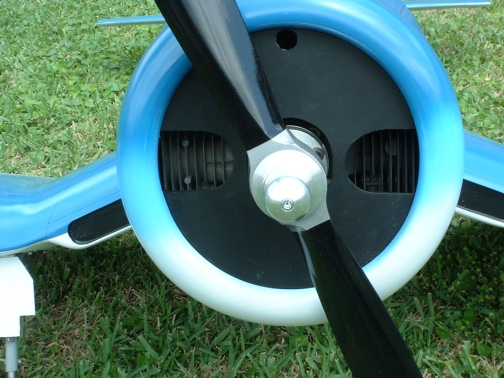

A 3 blade Bolly 21x13 will give you about 7200, I tried it on my Corsair and it worked well. I switched to a 21x12 2 blade Bolly and got almost 8000 and a marked increase in speed...Lenny

Hi Lenny:
Thank you. So what do they like to run at? Did you have any problems with over heating with the 3 blade?

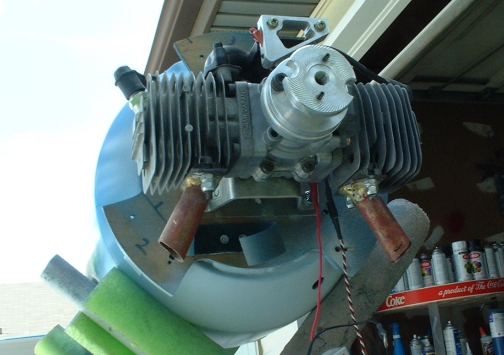

Like Ralph says, if you prop them for 7900 or more, the engine really wakes up. No overheating problems with the Corsair cowl, plenty of exit air around the side. I did limit the entry air to two openings right in front of the cylinders....Lenny
