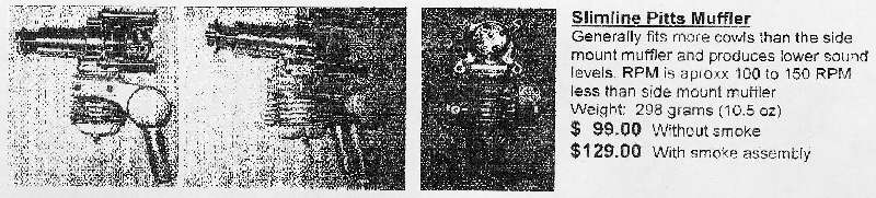

FLYBOY:
Do you have any idea what that Pitts smoker weighs. I am still tossing around engine choices for a Wild Hare edge and am trying to get weights of all combos.
Old 02-02-2004 | 05:47 PM
FLYBOY's Avatar
My Feedback: (11)
Posts: 9,076
Received 7 Likes on 6 Posts
From: Missoula, MT
Default RE: What muffler to use??
298 Grams or 1.5 OZ.
I have a sheet that shows them, but the copy is really bad. I will try to scan it and put it up.
Old 02-02-2004 | 06:24 PM
FLYBOY's Avatar
My Feedback: (11)
Posts: 9,076
From: Missoula, MT
Hopefully you can see this

FLYBOY
That's good thanks.
