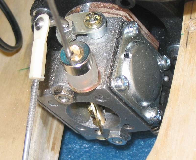

Need some info on throttle linkage for the Roto motors, specifically the horn that can adapt on stock horn on the walbro carb. If someone could post a picture it would be appreciated. This is my first gasser i have had that carb mounts in the rear of motor. Thanks Bruce

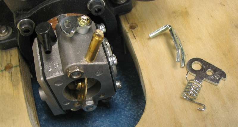

note mod to throttle arm -the ZDZ ball link is installed
I ground off end of stock shaft to release the stock spring loaded choke parts.
Note the clutch assy of washer and heavy silicone tube and 3/16" wheel collar.
this allows a firm twist of linkage to make the choke open or closed.
A arm may be used (such as a small nose gear steering arm) for servo operationof choke.

Thanks Dick i got your email also, appreciate the pictures. Bruce
