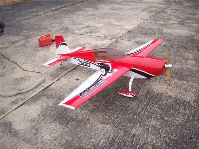

I have a tuned pipe system on my AW extra 300 & I love it ,never go back to stock mufflers again if I can help it. Mine is MTW header & RE2 pipe.The only difficulty I had was balancing the aircraft also keep in mind tuned pipe set up will add 10 oz to your aircraft compared to the stock muffler.

ES composites pipe only weighs 4 oz I believe. It's CF. The header is probably about 6 oz. You save maybe a half pound over the aluminum?
That's a sharp looking Extra, dam !!

Joe, I weigh both the header & pipe 7 oz each total 14 oz ,CF pipe 4 oz + 7 oz header =11,savings of 5 oz . Not a big deal on a 18 lbs + aircraft even though I am very weight conscious. What I did not like about the CF pipe is that is very temperature sensitive.By the way I installed a velocity stack as you suggested in previous post everything is bone dry.Keep up the good information.Almost 8000rpm on dle 55 , Vess 22-B just switched to synthetic .
