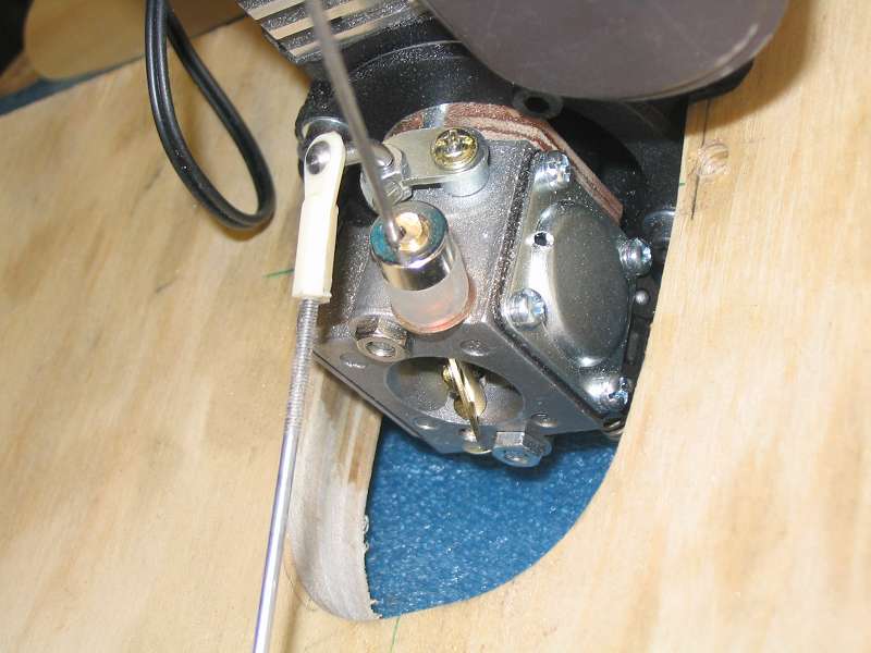

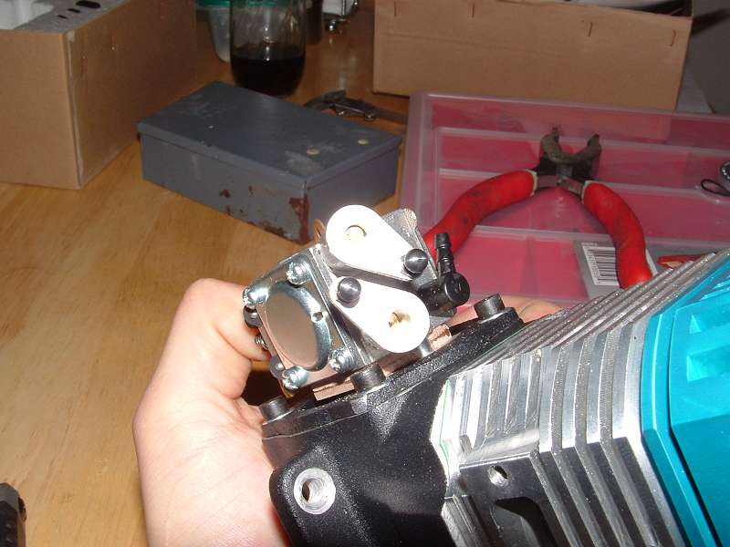

I removed the Walbro "snap to off choke" contraption from the carburetor.
Instead, I made a very simple drag clutch on the choke - so that I can just turn the choke on or off as desired.
Just like any other gasser -- you choke and flip -watch to make sure the fuel comes to the carb-
engae ignition and in a few more flips, it will burp start.
Then stop.
open the choke -
reduce throttle to low idle and again flip -
that's it.
here are a couple of pictures.
One pic shows th little forked choke to throttle link-which I removed .
The other show the piece of silicone tube and washer and wheel collar, which make up the drag clutch -to hold the choke plate in any position as you select by turning the 1/16" rod attached.

I like your choke setup! KISS principle at it's finest. It looks like there is a washer between the carb body and the piece of silicone, is that true? I am going to borrow your idea for my MVVS 26cc engine. I had a carb with the "automatic" choke on it and it started very easily, but it was way to large. I didn't want to burden my Ultra Stick with a choke servo, and starting an un-choked, cold engine is a tad tedious!

David - yes a flatwasher --then the heavy wall tubing, compressed about 15% and held with a wheel collar.
A short , heavy spring would also work-in place of the tubing.

I have two blue head ROTO 35cc units and they are reliable easy starters. I doubt its the batterys or ignition unit........pull the plug.......you are getting a spark or not..........this engine really needs to start WET.
Dick.........did you close up the holes on the choke plate at all by any chance? I find cold starts while reliable, take 15 flips or so full choke,full throttle,ignition on to first burp.......I was going to solder up the large hole in the plate and start back up with a 1/16 bit..........I like your choke link! so simple!

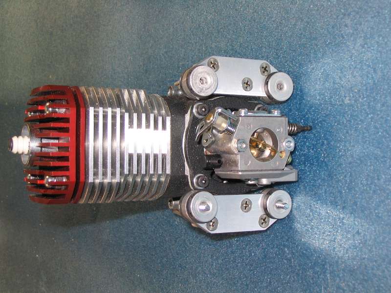

Here is a pic of the Roto35 running. After getting it started I had no problem tuning it. Compared to a nitro engine the tunig adjustments are quicker. Maybe 5-10 seconds after an input to the high or low needles. Because I have a long fuel lead, I have an extended time of primiming, so I'll just use a starter until she breaks in, or I find another solution.
heres a pic,
