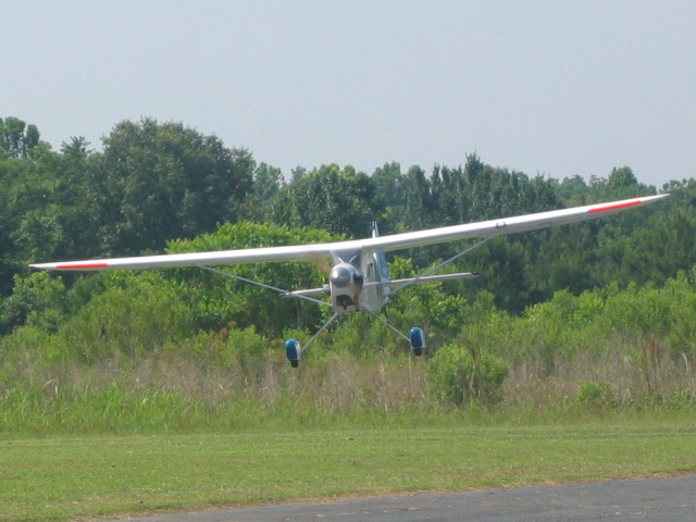

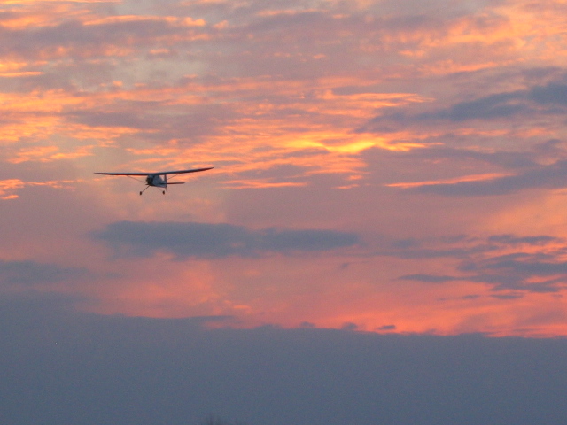

I have a club member that has a Rascal 110 with a G26 and if flys the plane very well. I don't think you would be disappointed with the G26.

Photos of my club memebers Rascal 110
ID:	147326   Click image for larger version
ID:	147327   Click image for larger version
