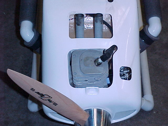

The BME 50 weighs 3lb.s 1/2 oz. the muffler the gasket and screws 4 oz.s the C and H Ing. 3.8 oz.s the plug .9 oz. for a total of 3 lb.s 9.2 oz.s. You have to have a motor mount too I use a Hanger 9 mount that weighs7.1 oz.s for a total of 4 lb.s .3 oz.s. Hope this helps.
I'm currently running the ZingerPro 22x10 and getting right at 6500r's. This kind of puts the engines in perspective, with Robert getting 7100 with a 21" and the 6500 with22". I may give the 21" a try sometime soon. I almost wonder if I can lean out the top end a fuzz. I did lean the low end just ever so slightly to clean it up a bit, that made a big diff. I do agree though, it is ballistic for a little 50. Shoot, these small engines have more power then some of the motorcycles we used to ride.
Here's my install, it's just a quick pic I shot ...

Just a suggestion, but you might want to protect the spark cable from chaffing against the cowl. It looks tight and could be a wear point over time. Thanks for the picture!

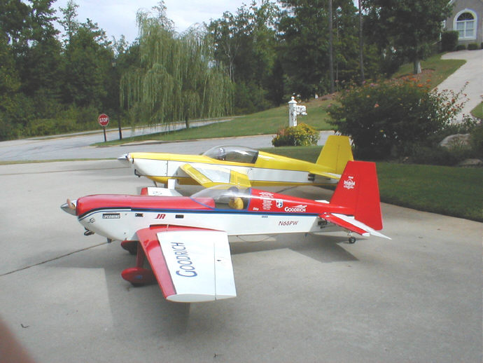

Geistware I do have one photo at this time. Due to the weather I am not planning on going to the airshow at Berry Hill. I fly at Griffin and with the Fayette Flyers. I would love to show you the airplane anytime.

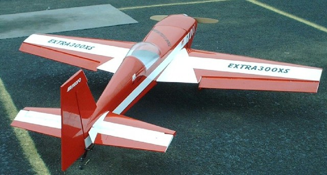

You know, Kieth said that he does not reccomend the JA Pitts Muffler because it takes about 20% of the motors power... I am using the stock muffler. Have you gotten a DB reading yet? Mine comes out to a startling 103db.... I need to get it down to 98 at LEAST but I don't want to loose more power, My Extra came out to 16.2 lbs, I wish I could find a way to lighten it. I built it all stock.
As you can see by the picture, I screwed up the flare blocks and didn't really notice it untill I glued the tail in.
I'd put the canopy on better, but I am looking for a decent pilot figure before I perfect it.
