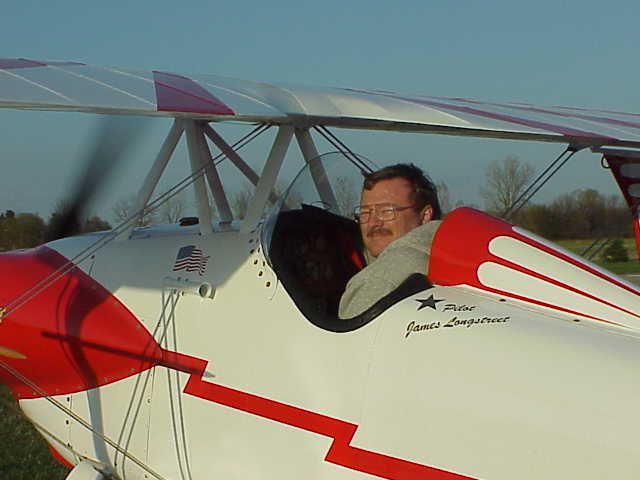

MalcolmL, as I recall Tommy used a Sachs (may have been A&M) 4.2 in his. Why not go first class and put one of the new light weight 100 cc twins in it? At 1/3 scale, it's pretty big.
Mere mortal,
Ken
Here is a photo of my friend in a Little Toot
