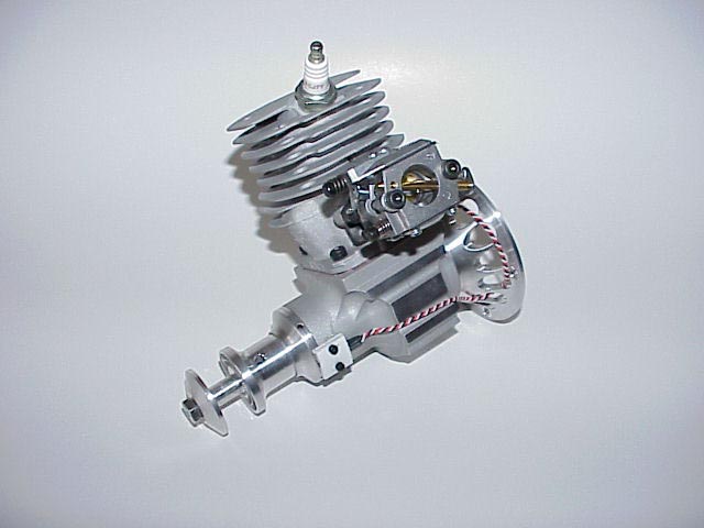

How do you define ugly?? What are you comparing ugly to? What is a good looking gasser in your mind? This is a first for me an UGLY Taurus Engine.... Everyone that has had there hands on one has commented on the craftsmanship and detail...
I'll have to get in line with Diablo on the loaded question summation... You do need some specific criteria to make comparison'c. Some of the manufacturer's only offer a few engines while others have one of nearly every size desired.
I happen to be a proponent of Taurus Engines, I have several of them. I like them all. I also own and have owned all you mentioned, I have also tried nearly every available gas engine at one time or another even the ZDZ's.
Currently the most powerful 40cc engine offered is the Taurus TS-42. Typical 42's turn Zinger's 22/8's @ 7200rpm with a stock exhaust system. All this power in a light-weight package that is second to none in power, transition and nearly no vibration.
As mentioned Taurus does use an industrial cylinder and piston assembly. Taurus manufacture's there own proprietary lower end.
I don't think there is a grand difference in the science or technology that an international industrial manufacturer with billions of dollars invested in the industry can utilize as compared to small one off companies that develop engine's for a very small cross section of user's. Cost, weight, performance and availability are most likely the commanding pre-requisites. Certainly engine builders can and do choose the components that best suit there wants and need's. They are not limited to anything specific, as they pick and choose the best component for the job.
That said if ZDZ could develop a 40/50cc engine that was more powerful, that exhibited the transition, idle and lack there-of vibration in a package that weighed substantially less, I would agree the purpose built components offered something more. As it stands to get close to a Taurus 2.6/42cc engine you have to use a tuned exhaust system complete with header and the associated components. More cost, weight and space required. I find nothing wrong with this approach, quiet models are the future of mode aviation.
Same goes for the new DA-50, the current performance numbers I have seen offered by DA are good but not better than a comparable Taurus Engine. Weight is comparable as well. Where is the advantage to these purpose built components.
The new BME Extreme purpose built component engines maybe excellent engines, time will tale.

Smoothness is not related to the number of bearings. As an example to disprove this claim, the Zenoah G-62 has bearings on both sides of the crank throw. It is not a smooth engine, at least I've never seen one that could be described as smooth. The ZDZ-60 has roughly the same displacement and 2 bearings in front of the crank throw, just like all of the glow motors. The ZDZ is also much smoother than the G-62.
Things that do effect smoothness are reducing the reciprocating weight (of the piston and con rod) and choosing the right mass of crank counterweight. Still, there is no way to achieve anywhere near perfect primary balance with a single. Boxer twins are much better from a dynamic balance standpoint, but they also will have a secondary vibration as a result of the offset cylinders.
A big factor that is often overlooked is the mixture distribution in the engine, the mixture setting (rich or lean) and the ignition timing. In a 2 stroke, if the mixture is too rich, then the motor doesn't fire every revolution, and the engine shakes quite a bit. I have seen some pretty bad vibrating boxer twins as a result of too rich a needle setting or possibly fuel puddling in the crankcase. A 1/4 turn of the low end needle on the carb can often really smooth out a vibrator. My stock 3W-100 used to vibrate a fair amount, and could not be smoothed out with tweaking the needles. I compared it to a friend's 3W-80, and his engine seemed like an electric motor. I finally added the carbon intake horn to my motor and there was a dramatic change in the smoothness throughout the rpm band. My motor is now as smooth as the 3W-80. The only thing that changed was the mixture as the motor came off idle.
Having never seen a Taurus, I don't really know if they are as smooth as claimed. I can offer up a theory; they might be smooth because Stallspin knows how to adjust the carb properly and does this on every engine before he ships it out. The other manufacturers rely on the customer to adjust the carb. Vibration is a funny business, with lots of claims, but no hard data for comparison. Lots of anecdotes.
The post said "two ball bearings on both sides of the crank throws"..Two on the front is a very good idea, makes the crank more rigid, just like a cantilever, as the hub is almost next to the front bearing..Two on the rear is maybe overkill, but if the crank is PERFECTLY straight and concentric it could be the reason for the alleged smoothness of the engine..I'm working on a 62cc Zenoah converted INDUSTRIAL engine, not a chainsaw, that comes from Zenoah with two bearings on the front and one in the rear..Should be smoother than the G62 because of the close proximity of the front bearing to the prop hub..The only common parts between the G62 and this one are the bearings and seals..Should weigh about 4 and 1/2 lbs and will have electronic ignition with electronic advance..Looks good so far, ignition in the square rear crankcase casting...

If I was guessing man, and I'm not I would guess some engineers from long ago decided that there was a marked improvement in a rigid rotating assembly that fully supports the crank-pin with double cheeks/counter-balances.... It's obvious to me that a fully supported assembly will in fact run truer as oppsoed to cantilever design, such as ZDZ, Zenoah, Brison, FPE, Air Hobbies and many other's...
Let's consider what the big dog's [3W and DA] in the industry are doing with there lower end's. Double cheek, single throw crankshaft's with bearings at either end of the assembly. Same engineering design concept Taurus use's on all there engines...
I whole heartedly agree with Diablo and Ralph's assertions on the complexity, merit's and tuning aspects of all model engines...
Attention to detail such as hand fitted, clearanced and machined assemblies, balance factor's or ratios that work, superior engineering concepts, timing and tuning procedures that offer the best real world results equals ====== Taurus Engines..........
I have done this, I suggest some other's do the same obtain a Taurus Engine and make the comparison... I know of several other's that have tried the rest achieved similar result's and now realize the Taurus Engines advantage...
Another mentioned long term reliability, most, if not all of these engines are designed to live for at least 1000 hours of use. This is already a known for Mahle [Sach's, Makita, Dolmar, Husqy]based engines and many other's. Some have yet to prove themselves...

Yep, your correct Zenoah's do have double cheek crank's. My mistake...
There are many engine's utilizing a double cheek design. Obviously there not all using the same balance factors or ratio's. As Diablo mentioned tune-ups play a factor. Additionally ignition system's contribute here as well. The smoothest single cylinder will have a properly matched carb, low friction loss HP numbers, auto advance/retard ignition system and balance factors that match the application. I believe the rigid rotating assembly of the double cheek crankshaft design allows more energy to be converted to usable power, this is realized via the transition, rpm, torque and smoothness.
It's much like the real world of automotive engine design. There are many aftermarket components offered to enhance performance. The right combination of these parts and hands on massaging creates a high power engine, the wrong combination creates an engine with less than desirable attributes...
DA's new 50 does utilize a cantilever crankshaft design... I assume weight and cost were a factor. The 50 makes respectable power. The rpm numbers I have seen are comparable to other engines in this class, if not less...
