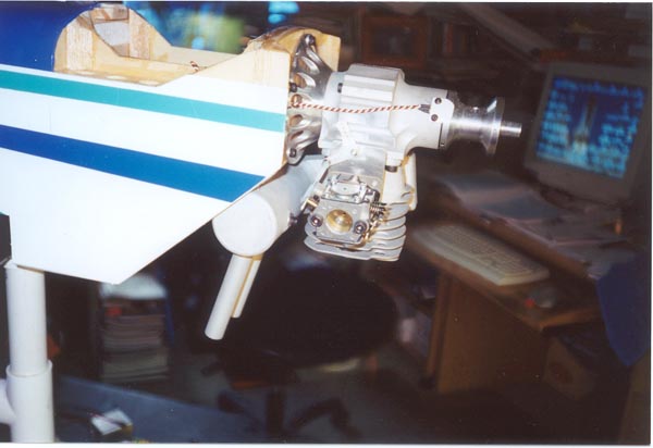

My DP330L is just about done except for the installation of the choke. Can you tell me how you hooked up the choke on your taurus 2.6.
Santi

Mine sticks out of the cowl so no need for linkages, just use my finger to open and close.
Doug

I connected a little tab to the choke arm and ran a rod down under the cowl.

I also connected a little tab to extend the choke lever. I just stick a long hex wrench in through the cooling slot and turn it on and off.
For what it's worth. I have found the best way to start the Taurus is to leave the ignition off, choke on, and almost full throttle. Flip the prop over until the engine sounds "wet." Then open the choke, reduce the throttle to idle, turn on the ignition and flip the prop. It usually only takes a couple of flips to get it running.

I remove the funky little metal arm and install a nylon nose gear steering arm on the shaft. [something like you'd see on a trainer with tricycle gear] I then proceed to connect it with a nyrod type control rod and sleeve and send it to a small servo for choke action via the TX... You could of course simply drop down a small length of the nyrod tube so that penetrates a small hole in the cowl and manually operate it.
