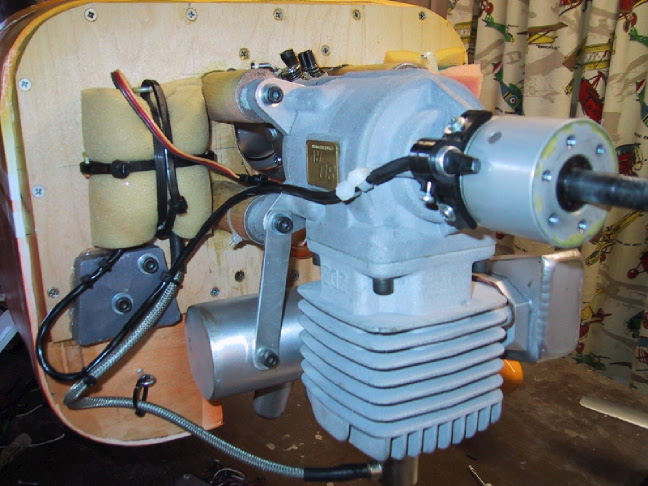

I have a ZDZ80RV and a Brison 5.8 and I highly recommend both engines. Both will turn the same prop at close to the same RPM. The 5.8 may have a sleight edge.
I don't know much about the Fox 5.8 but it probably runs very well. They sure are proud of it because it's $145 more than the Brison.
One more consideration is the rear carb on the ZDZ80RV allowing a very clean engine installation. You also need to think about good cooling air flow across the engine. I wrote an article on baffling and it can be found here under the FAQ section. www.rcshowcase.com

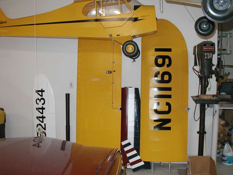

O.K. Here's an update on the Cub. It's completely finished - just waiting for an engine. It is 40% scale, 14.5 ft span, and will weigh in at close to 40 lbs. It is covered with Ceconite, doped, and painted with latex paint. If it flies as good as expected, I will make plans available along with a complete building instruction manual. See photos below.
Jim, that is one beautiful Cub. I think you will like the 80 in it. I use a Bisson Pitts style muffler with clipped tips and the engine turns a Menz Standard 26x10 prop between 6100 and 6300 depending on the humidity and temperature.

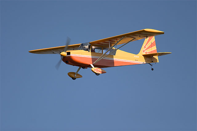

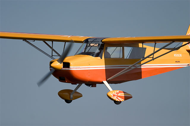

Here are a few shots made at Bomber Field this year of my 1/3 scale 126" wing span Hostetler Super Decathlon. It weighs 32# and is very aerobatic.
Ken

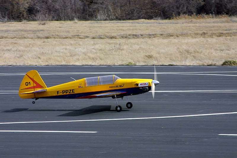

Nice to see what everyone is building, great picks, and work! here's my Ultimate. Span 80" length 82" 25lbs, 2080 sq in, ZDZ 80.
http://www.geocities.com/krcm_home/2...z_ultimate.jpg
