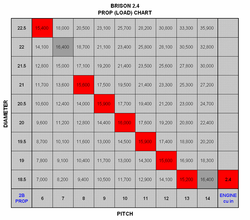

I have a Brison 2.4 on my 28% Ultimate and have been running a Zinger 20x10. I would like to switch to a carbon prop, possibly Mejzlik. Should I go with Mejzlik and should I stick with a 20x10 or should I go with their 20x9 or even 20x8?

My Brison 2.4 turned a Mejzlik 20x10 @ 7100 rpm.
Good prop for aerobatics.

Here's a Prop (Load) Chart based on the information from Diablo-RCU.
It looks like a tuned exhaust system would greatly improve RPM.
"Brison 2.4 @ 7100 RPM"

What does the 16K stand for?

Yeah what do all those big numbers in the boxes stand for? I kind of understand everything except the numbers in the boxes. They go up with pitch and diameter.

A 20x8 or 21x8 menz works well for good pulling power. Or a mejzlik 20x10

The number in the cells represent the calculated load of the prop selected.
Prop Load = Diameter^4 x Pitch /100
20x10 prop would be figured as: 20^4x10 = 1,600,000 /100 or 16,000
Now all you need to do is following along the chart fiinding like vaules and your engine should turn at the same RPM, utilizing the same Prop Load.

I'm lost! How does that help in figuring out what prop to use etc???

I think that he used the 20x10 @7100 RPM that Diablo-RCU mentioned in his post. He took the 20x10, calculated the load (16,000) then found all the different sized props that would load the engine to 16,000. I believe his graph assumes a peak RPM of 7100 for all props shown on that graph. It would be better if it said at the top of his graph "Brison 2.4 @ 7100 RPM". That's what confused me, I didn't know the RPM was constant across the entire graph.

You are correct Joe and your "more gooder" explanation is appreciated >
