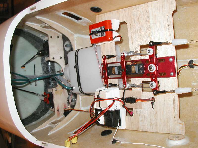

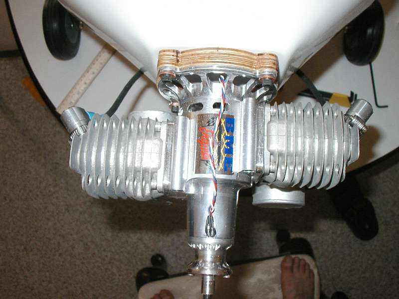

RTK - I sent you an email on your set up. I have a C arf 2.6, but no engine yet. Where is your balance point in relation to the recomendation? Do you know what your (real) weight is? I have been told by others that this combo will not balance. I have light batteries (3 2350 2 cell li-po) so I only have 10.5 oz of battery to move around. I have a single 5735 for the rudder that can be anywhere.
JD
Old 01-05-2005 | 09:15 PM
RTK's Avatar
RTK
Joined: Apr 2003
Posts: 4,890
From: Left Coast , CA
Default RE: New BME 110
JD- This combo will balance. My CG is right on Comp-arfs recommendations. I am using 2-2700 nimh mounted on the motor dome. Also I tried to include a pic, don't know if it will come thru though. I usually go for the KISS principle. No match boxes, power boxes, etc.

Ralph,
Nice Work!!
