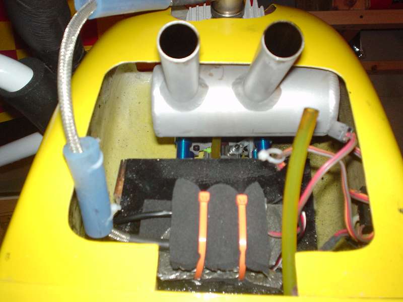

This is how I shield the ignition cable, notice the silicon tubing wrapping the cable only on sections were is more likely to suffer damage mainly due to the proximity of cowl edges.
By the way I did not think about the spiral wrap, I think is a good idea too, I will try next time
