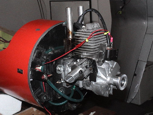

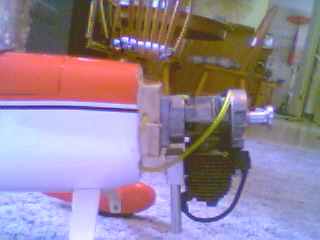

I have an almost new US-41 installed "Inverted" (spark plug down) on a 1/4 Decathlon. The problem is that since the engine needs some fuel priming on the carb before it can get started, the spark plug gets wet with fuel and a spark is not generated, therefore the engine does not start. I always have to remove the spark plug to dry it and after that, the engine starts more easily.
My questions are:
1)- Could this problem be caused by improper spark plug gap or improper magneto gap? if so, what should be the correct gap spacing for each?
2)- Is there an easy way to add a prime bulb or choke instead of having to add fuel to the air intake? (on another plane, I had no starting problems using a Zenoah 38 with a choke)
3)- Should a Sullivan Dynatron Super Starter (Torque= 340 @12V) be able to turn the prop or should I used a belt driven starter? I tried this starter but it didn't turn the prop, maybe because of the battery or because I have no spinner installed? any suggestions?
Thanks.
My questions are:
Thanks.

The spacing of the coil off the flywheel is the thickness of a business card. With the magnets under the coil, Raise the coil up and place the business card under it. While holding the coil down against the magnets on the flywheel, tighten the coil retainer screws.
The spark plug gap is .020"

I tried the Dynatron alone on 12V - could hardly turn it over! The Miller geared unit would not spin it fast enough on 12V, but on 24V it kicks it right over!
Yes, it is the Miller belt drive unit advertised in many of the Mags. I purchased mine at RC Country in Sacramento (My LHS!)
Tom Perry can set you up with ignition for your US41 - Do a search for him in RCU - He goes by Tom Perry

The US engine is equipped with a magneto. A magneto delivers a spark relative in strength to the rpm that the flywheel is spinning. The faster it spins the stronger it's spark, to a point.
Vince
Vince
Like w8ye said a business card is a good tool to use for setting the gap providing you don't have a gap gauge.
Does this engine have a choke? If it does then prime the engine by choking it with the spark on. Flip it until you hear the engine pop or fire once. Then remove the choke and flip again until it starts. By doing it this way you won't have raw fuel sitting in the plug. If it doesn't have a choke you could easily make one with a piece of tin that you can slide over the end of the carb for priming.
The choice is yours, a 1-2 hundred dollar starter or a piece of tin from your coke can that your gonna throw away anyway...

That system works well with an engine that has electronic ignition, but the US41 has a magneto and is practically impossible to start by hand. Mine would start with the spring starter after it had been started with the Miller for the first start of the day, but hand flipping? - never saw it happen, choke or no choke. Maybe after several gallons of run time and it has loosened up considerably.
The choke, pop, and start work fine with my Q52 and Tartan twin on CH ignition, but the US41 magneto still needs the Big'un!

Thank you all for your comments. In fact, the voltage developed by a magneto is proportional to mainly three variables:
1)- The magnetic field strength (which is proportional to the magneto gap).
2)- The rate of change of the magnetic field over the magneto coil (which is proportional to the prop RPM).
3)- The number of wire winding turns inside the magneto coil.
There is a saturation point above which no increase in voltage is produce. The other thing to consider, is that you might have a very large voltage, but if the magneto coil is wind with a very thin conductor, then it's internal resistence wiuld be so large that it would not be able to produce enough "current" and the spark would be weak. In general the greater the voltage, the lower the current for a certain amount of power. I think the magneto on this engine produces weaker spark than that of Zenoahs for instance,
I used to have a Zenoah engine and it started very well using the choke as previously mentioned and the spring starter. I am being able to start the US-41 with the spring starter, but I definitely have to dry the spark plug after I manually prime the engine, otherwise it won't start.
