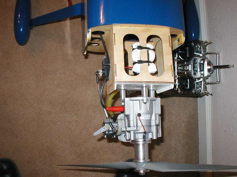

Default RE: G26 conversion
I have seen some so called conversions but I'm talking about taking off all of the coils and the flywheel to save weight and cutting off the extra steel crank on the back of the engine ...... and installing a magnet and the sinsor with out any machanical stuff on the outside......... you know like the DA and ZDZ engines
there must be a problem with this because I have not seen the G26 done this way

so you take the flywheel off and put all the ignition components in the cup mount
Old 02-07-2005 | 02:36 PM
Antique's Avatar
Posts: 9,825
From: Somewhere, DC
Yes

That is what I wanted to know .... that web site does not have a good pic. of the back of the moter....

Ralph,
What do you do when the setup cannot utilize the mounting cup? My Hanger 9 Cub uses a flat plate. Can we still do the conversion?
Regards
Craig
Old 02-07-2005 | 09:18 PM
Antique's Avatar
Posts: 9,825
From: Somewhere, DC
The only change on a G23/G26 is a .050 thick plate across the back of the engine, the ignition fits in the space where the flywheel was..Other engines with no space can be converted with a separate box for the ignition..[8D]

cknaack- I don't know if this will help you, but this is how I mounted mine. It would have been flush mounted but I needed about 1 inch more.

RTK,
Your picture says it all............Thanks for the clarification. It looks like a nice clean setup.
