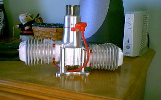

You might want to consider this engine. I should have mine Friday. They incresed the :boxing: cc from 97 to 106. Bobby said they had one in Germany swinging a 30x10!, and it still weighs 5.9lbs. I will let you know how it runs as soon as it is delivered.

Bobby Wilson at Cactus Aviation just received a new shipment of 3w 100's. But these are even a newer style that have been upgraded from 98CC's to 106cc's. When I was in Germany they had them on the test benches and they were turning 30x10 menzs props at 6,000 RPM. It is a very strong engine. It is also only 5.9 pounds. Maybe this will give you some food for thought.

30x10 Menz at 6,000 rpm is mighty impressive. Actually sounds too good to be true. The reason I say that is my buddy HT has a new 3W-150 that turns a 32x10 Menz prop at 5,300 (with about 10 gallons through it). I would expect it to turn under 6,000 with a 30x10. Did they have a tuned pipe on that new 106cc motor?
Spindoc, I'd be very interested in seeing rpm numbers posted from your engine when you get it fired up. Also, how much is this motor going to cost? Do I need to have the smelling salts ready?

Suprisingly the price of the engine has stayed the same! As soon as I get the engine, I will post some numbers. Bobby told me that it had no problem turning a 30x10 but he never told me any numbers. I will give you guys an honest evaluation of how it runs and the rpms it turns.

One thing to remember is to break it in really good before you load it to much. I would start off with a 3w 27x10 or so and work up after 20 gallons.

You know, I have been giving this entire 3w106 "thing" a bit of hard thought. . let's stop and take a HARD look at these numbers.
First off. . it's quoted by Garrett as turning a 30-10 Menz-s at 6000 rpm. . . then you go to the Cactus Aviation web site, and the biggest prop it lists for this engine is a 30-8, so is it supposed to run on a 30-10, or is something amiss here?
Then you start thinking about engines that have PROVEN they can turn these numbers with a Menz-s 30-10. . Motors like the 3W TOC140 or a Standard 150, or perhaps a 3w120TOC on tuned canisters. All three can turn the Menz-s 30-10 in the 5900-6100 range, day in and day out. Then you stop and think about it. . a 106cc engine is turning the same rpm as a TOC140 . .. that's a 35% smaller engine holding it's own against some very capable machinery.
Right about now you could say I am a BIT skeptical.
As for Menz vs Mejzlik RPM numbers, my Menz props have always turned slightly higher rpm figures than a comparably sized Mejzlik .. compare them at about 6350 for my 150 on pipes for the Menz and about 6150-6200 for a Mejzlik, both 32-10's. But, you know, it's only numbers. We can quote them all day long, but they mean NOTHING until they do it every day of the year, from every engine sold.

I will also be surprised if this engine turns a 30x10 menz s at 6000 rpms, but I will not be disappointed if it does not. If you think about it, many of the older 100's (97.3cc) were spinning 28x10 menz s props easily over 6000 rpms. The new engines, at 106cc, should show a noticeable power increase.
Also Kris, you state that the BME 110 should be broken in on a 28x10 Mejlick and then run a 29x10 Mejlick. This seems to be a pretty bold claim, especially since you feel that a Mejlick is a higher loading prop than a menz s. I have not seen any numbers on the BME (102cc ) that are even close to that of the old 3W 100's (97.3cc). The only way to know for sure how these new "production" engines run will be for people that have them to post honest results. When my engines arrives I will be sure to let you guys know how it performs (good or bad) and I will give you accurate numbers (no rounding up) so you will be able to draw your own conclusion. I hope you will do the same when you get your BME 110.

I agree with you Kris. I should be able to fire it up this afternoon and see how it runs. I am really excited about be able to pull about 2lbs out of my plane just by switching engines, taking the smoke system out and pulling off a bunch of tail weight that I needed to balace my old 3w 100. Hopefully I can give you guys some feedback this afternoon.

Had a chance to fire it up this afternoon. I started with a Menz 26x10s and quickly took the prop off. It started on the second flip after choking. I gave it about 1min to warm up at 1/4 throttle then I slowly advanced to full throttle. After about 10 seconds at full throttle, the engine cleared out and was spinning the hell out of the 26x10. I switched to a 27x10 Menz s because I was afraid of over revving the engine. I started it back up and was able to tach it at 6300 + or - 75rpms. The top end was very rich, the engine would load up then start to clear out then load up again. Throttle response was very quick up to 1/2 throttle then it would start to load up from about 1/2 to full throttle. After a couple of gallons of Lawnboy for break-in, the engine should pick up a couple hundred rpms and be a MULE :devious: .I should get a chance to fly it this weekend, will post how it runs in the air.
