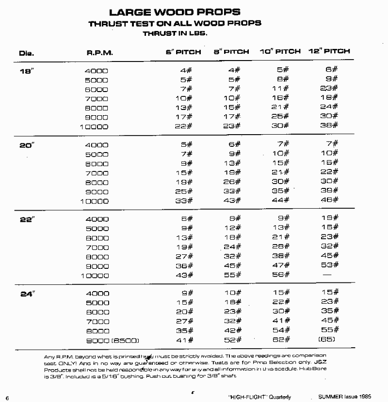

recently I test my SPE40Z engine with 21-8 NX prop ,(this prop are as same as BME prop) , and got 6200rpm . how much for the stastic thrust ? anyone have experant of BME OR NX prop?

Best guess, about 16 lbs.

This might help.
