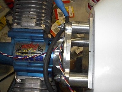

The stand off's will work here is a pic of how mine is mounted on
my DR Hobbies 2.6 Also go to the link click on kit photo and there are more pic's at the
bottom of the page
http://bpassociates.homestead.com/ExtraRep.html

The stand off's will work if you have aluminum stand off's and the aluminum plate for the stand off's to sit
on, this keeps the firewall from compressing. The problem that I have had using wood spacers
is the wood will compress and the bolts will loosen up. When you tighten them up
you can change the thrust in the motor. I have shown Keith the set up on my plane
and he liked it because there is no way you can warp the motor mount because of the
plate on the firewall. ( one other Pic I forgot this keeps the firewall from compressing)
Hope this helps

What thickness is the aluminum plate.
Do you mount one on both sides of the firewall?

They are 1/4 plates, if you have the 3in hole in all plates the whole mount weights 9oz

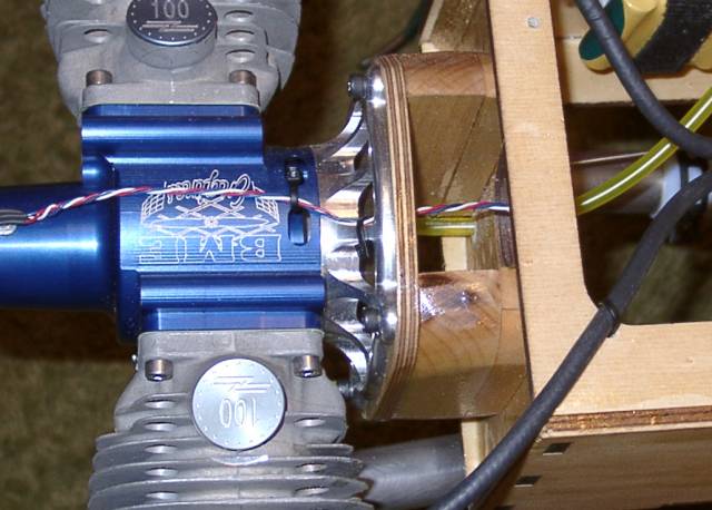

Here's the mount I made for my BME 105. It sets the motor out about 2" and fills Keith's bill for support around the entire circumference of the radial engine mount. It's seen hundreds of flights and this year will be its third year of duty mostly behind a BME 110. It's light, builds quick, and I can say that I've not experienced any compression of the wood in the motor mount and resulting loosening of the bolts. Many ways to skin a cat, for sure, this has proved absolutely trouble free for me.

Tim_Indy
The solution is pretty neat!
Is there any reason (more distance away from the firewall allowing better cooling...) against mounting the engine directly on the firewall as oppose to using standoffs?

Albatross, the only reason I didn't mount directly to the firewall was I needed to set the engine out 2 inches for the spinner to properly mate with the cowling. I originally had a Great Planes 330L kit and simply built the motor box long enough to mount the engine directly on the firewall. Engone cooling was never an issue.
