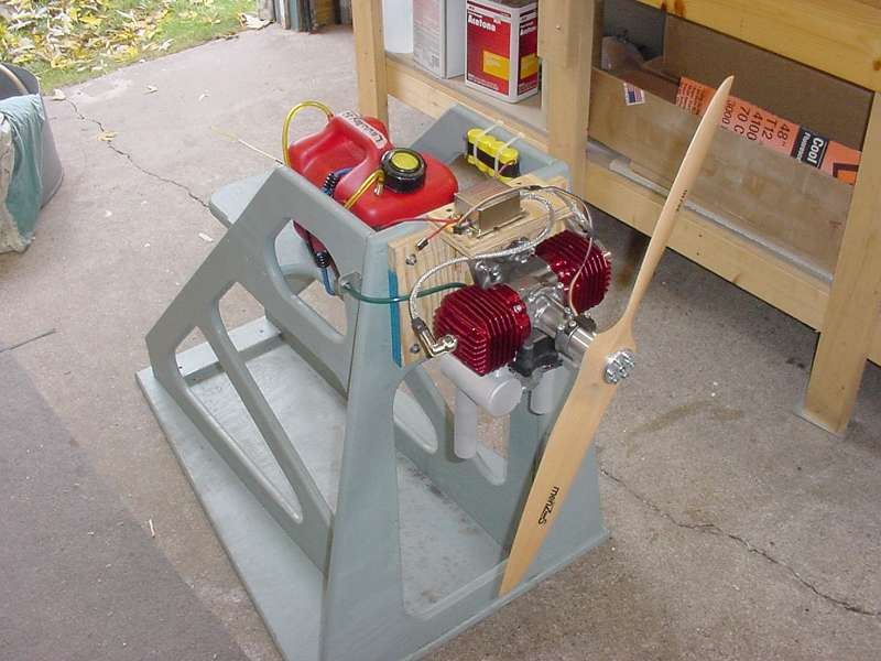

The Gas Cities stations in our area sell 100 octane racing gas. I just bought 5 gallons 2 weeks ago it was $4.49 a gallon. I have been using this stuff for 2 years in all my gassers. Its good stuff

Old 05-08-2005 | 10:13 PM
EJB
Posts: 341
From: NW Indiana
Default RE: High octane gas?
Using that 100 octane Walt's test stand can pull out of hover at less than half throttle.

KLOTZ,
Nice engine test stand. [sm=thumbup.gif]
Bruce
Old 05-09-2005 | 11:59 AM
My Feedback: (16)
Posts: 12,942
From: Locust Grove, GA
Man that test stand does look good.
Where did the weldments come from?
