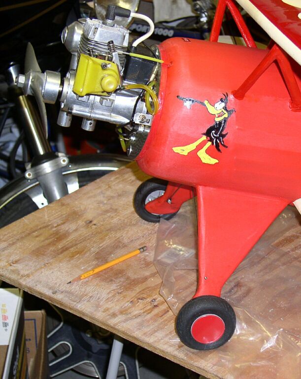

Ronning 14x6 prop......poor low idle but a very good running engine on a 1/6 scale Waco

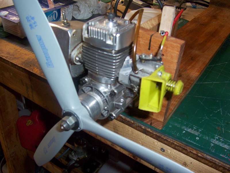

I gave one of my 1.25s what I consider to be the ultimate hop up, I converted it to Diesel and it now turns the 15x8 3B Graupner pictured here at about 7,100 rpm. The muffler is a J-Tec Snuffler specifically for the Maloney.
