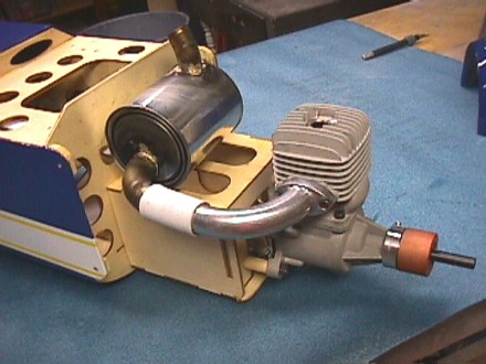

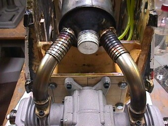

OK here are some pics of my stuf from KS tubing -
I tilt the engine for a simple system setup and it doesn't make the plane fly lopsided .
The only problem with the KS-is many "model builders" can't/won't learn to silver braze.
It does take practice and if possible help first time from some one who understands it.
I build the system right in place -on the model .
And I don't burn the model or the engine .
How? SS is very poor at heat transfer - I can hold -bare handed - a 6" piece of tube while I tack the other end.

Hey Dick- What type of can did you use in the 3rd picture?

a steel paint can - really-also on the 2nd pic- with baffles
the 50 on the small paint can actually was a tuned setup -surprised me !
I set the engine rich on a flight -and the darn thing unloded in the air -hard -
not a good tuned setup but nevertheless ---

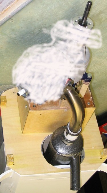

I did that same exhaust with inverted ZDZ-80 on the Sukhoi last year, complete build with pictures, instructions and parts. Click on this link to my web site. www.tangoncash.com go to Tuned muffler build page.If you have any questions e-mail me and I will answer as soon as possible.

I saw your KS can setup on your EDGE - looks very good .
We opted for a BIG JMB on a very short header
only real noise is prop noise. will change prop load a wee bit .-this one unloads as it climbs .
I used a DA150 header , modified slightly.
