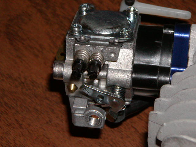

I was just running my bme 50 the other day. I was just looking at it and I think it is missing a screw or something under the carb. There is a hole under the carb and it looks like there was a screw in there, I can't remember though. I think it also is the throttle stop. Any ideas on what part I am missing???

I havent put my BME50 in an Airplane yet. Your not missing a screw. Here's a Pix.

Idle SPEED,not MIXTURE screw..Most flyers use the throttle trim to kill the engine.....

gadgetman
What is that black thing that the throttle hits. I am missing that i guess. I thought it went throught that big hole. Guess I should have looked at it closer before running it. lol

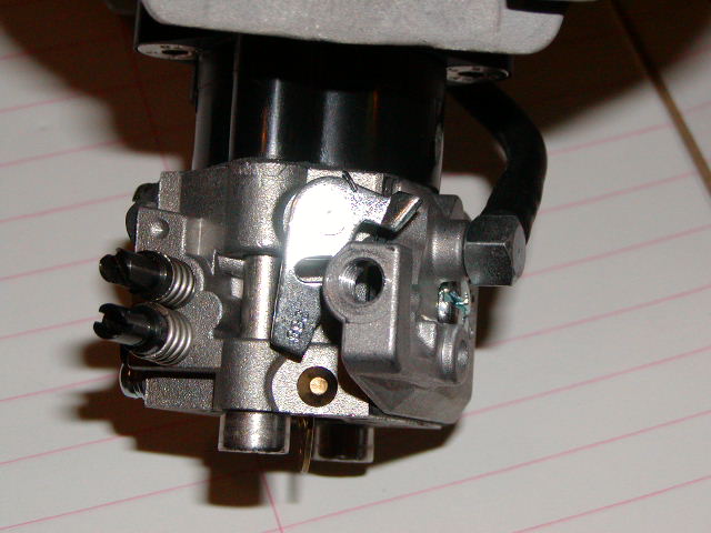

I dont see a black stop near the throttle. Here's another angle shot.

I must be seeing things. I guess I should stop looking out in the yard for a piece that I am not missing, lol. Thanks alot. I just could not remeber if anything was there, and it looks like something should be there . Thanks for the pics

The piece that is missing is the idle speed screw. Being that most people need to close the throttle completely to kill the engine that piece isn't used. If it was there you could not close the throttle to kill the engine.
