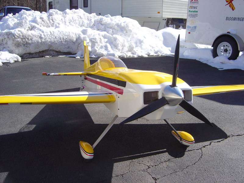

cut the squares out of the front, and then build a balsa box on the sides, top and bottom of the openings that go to the cylinders, not touching them, but very close. This isnt a great pic, but gives you an idea, ask if you have any other questions

Exactly what i needed
