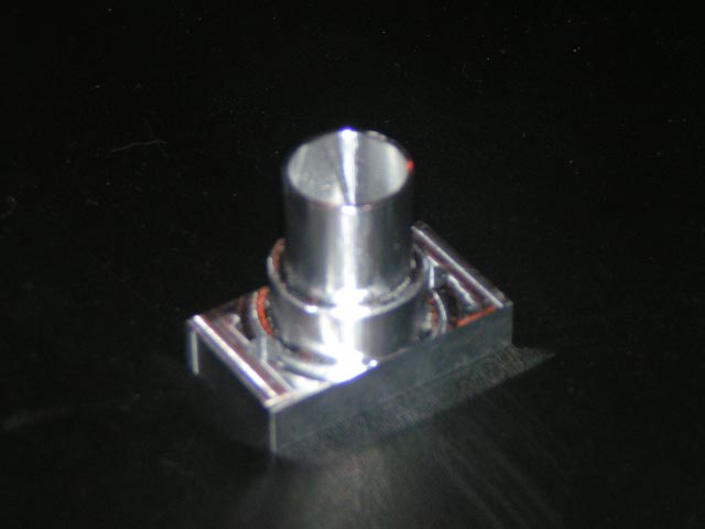

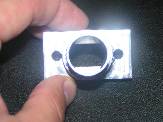

Old 07-25-2005 | 07:59 PM
Joined: Sep 2004
Posts: 203
From: saegertown, PA
Default RE: Question on exaust design?
I haven't gotten alot done on this project but I did manage to widdle out a proto-type exaust manifold today. What do you guys think of it?
Pete

Old 07-25-2005 | 09:26 PM
rmh's Avatar
rmh
Posts: 12,630
From: , UT
17x6 prop -and thrust was 13 lbs as I recall -on that prop -
I am going to put it in another plane -sold that one a while back -
Thrust means something -only when comparing
I wanted a prop which flew the model smartly as well as delivering decent static thrust --I used an APC
