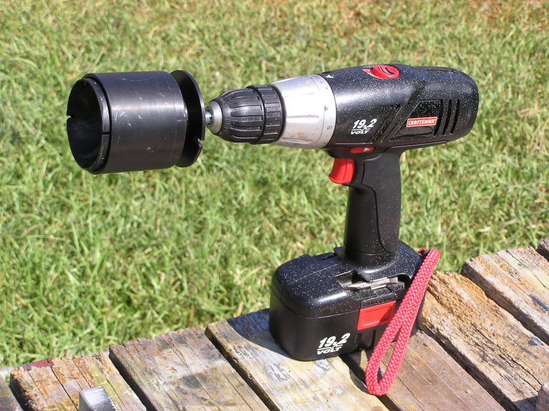

I use a 400in-oz, 19.2volt Craftman's cordless drill with the large cone drive from Tower Hobby. It starts my G62 with no problem, and gets a lot of use around home.
That's really clever chuck l. That's also a good testimonial for that drill. That's the first time I've seen someone post that solution. It sounds like a great one....if you have the need to use an electric starter.

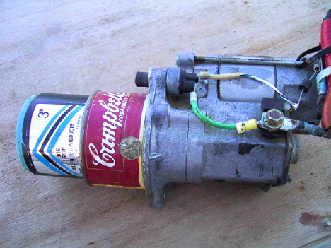

Once upon a time in a land far far away I won a door prize that was an ACE pull cord starter. It was about as useless as t*** on a boar hog. One day when my mind was in idle I spotted this device in my corner trash can. HARK, I might be able to make an electric starter out of this device since I already had a well broken in Craftsman drill motor. In about 30 minutes I had what you see in the photo. It has boo coo torque for starting a G62 but since my G62 has a "Jump Start" I have nothing to use it on. If I would keep my mind busy (computer, TV, yard work naaah......) I wouldn't have time for this foolishness.
This is also the case for another starter that I built from a Nippondenso geared V6 starter. At the time I had a Sachs-Dolmar 3.7 engine with a magneto. The finger guard really sets it off. This will easily spin a DA-150 but why?
I still stick with post # 3.

Hey Chick, How much you pay for the Craftman drill?
Old 09-25-2005 | 04:07 PM
My Feedback: (17)
Posts: 1,427
From: Goodyear, AZ
Default RE: Electric starter for 50cc engine ?
AirTech,
The first link is the one I bought two years ago for about $130. The second one looks like it would work also. They are the same as Big Bird's picture, the one without the Campbell's soup can.
http://www.sears.com/sr/javasr/produ...00&tab=spe#tab
http://www.sears.com/sr/javasr/produ...00&tab=des#tab
These are the two parts drive cone parts I purchased from Tower. I drilled out the hole in the metal drive cone and put a bolt through, and locked it in place with a nut. You'll have to grind a flat on the bolt threads in order to get keep if from spinning in the keyless chuck. I have one engine that only has a nut holding the prop on. I sawed off a 3/8' socket extension, ground a flat on it, and use a socket for turning the engine over.
http://www2.towerhobbies.com/cgi-bin/WTI0001P?&I=LXL404
http://www2.towerhobbies.com/cgi-bin/WTI0001P?&I=LXL403
I hope this helps,
Chuck
