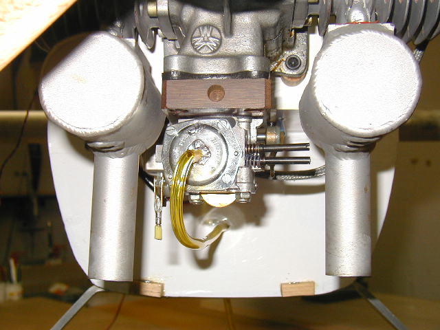

Getting a pressure in syn on a two stroke is the HEART of why two strokes can perform so well.
The tuned two stroke is really done, starting with the exhaust tune.
I have played a fair bit with the 80 single and 40/60 singles , trying to find the smoothest tuning setup.
Not the peak power setup.
I have a ZDZ prototype intake bell-you can see a picture of one on the RE 40 on the Amelung site.
These are not yet released for sale.
Mine also has a coarse wire screen over the mouth.
As soon as my RE 40 arrives , I will see how much this bell helps.
Basically , I see it as a flow straightener-which is a good idea.
The only problem is that on the smaller bore carbs, the choke plate and bar is a big blob -in the way - so - I may remove the choke assy, clean up the carb and put a flapper valve on the bell for choking. this works well and is common use on some OS four strokes.
So far I have found that a tuned pipe-such as the K&S 80 can- with a 11-12" header is the easiest setup for most to use.
I have tried the full length tuned pipes also - any gain there is not worth talking about .
A big version of the VTech tuned can works great -but noisy and not as smooth.
o -once I get a tuned setup on my 40 in my new Hee Haww model ( the Clipped wing Taylorcraft), I will see if the intake bell setup helps that one.
It shouldn't hurt--
We have two 80's running with a tuned can setup from Europe which is discontinued (Damn!) similiar to the K&S and again using the 11-12" header.
We also have a Walbro carb on both and the performance is simply heartwarming.
These two engines are both turning 27x10 MenzS props at 6200. this and no midrange step- in fact you can NOT detect any transfer throughout the entire powerband.
We are setting up another one to see if this is a fluke,luck or whatever.

Thanks Dick for your thoughts. When I first saw the ZDZ-40 RE with the velocity stack, a bell went off in my head. I was hoping that ZDZ would start selling the stacks as an option. I also found out that 3W has a velocity stack for the 3W-100 on Aircraft International's website that should also bolt up to the ZDZ-80. They get $17 for it. I plan on putting the stack on the carb and maybe adding a section to it to get the desired length. You're right that spinning it out of aluminum would be a cheap way to make it. Actually you could draw it from a flat plate in a die, but the tooling would cost more. Certainly it could be CNC machined, but you'd be wasting a lot of metal. Some of the older guys might remember V8 Chevy racing motors with Weber carbs, a single venturi and long intake tube for each cylinder with the stack on top. Same thing all over again. I'm sure you are correct about the exhaust system being critical to the power, but for my H9 Cap I'm just going to use the J&A Pitts, purely for convenience. I've got my buddy Hyper Tom convinced on the need for a K&S system for his new Aeroworks 31% Extra, and EJB is building the plane for him. Tom needs a quiet plane for Imac.
Another random thought - Have you tried modifying the intake rotary valve timing? Many years ago Kawasaki made a hop up kit for their Bighorn that used a longer opening for the rotary valve, along with a pipe and carb jets. I know we're not after HP at high rpm so maybe this isn't the way to go with longer timing.

I will surely grab one of the 80 bells! Thanks for the tip.
I tried a 7 degree increased opening - no improvement -I gave it away - I got it on a trade engine -from Randy Villines.
The engine was fine -but changing back to a stock opening proved the best setup.
I always am puzzled by the desires to change openings etc-- these are the easiest changes for the manufacturere to make -so why didn't he see the advantage.
One these two strokers the BIG advantage is a tuned system which matches the engine design.
when done right - the exhaust tuning also creates maximum pull at the intake -
I have a Pitts muffler on my Bucker but justfor the smoke novelty.
It is a noisy thing.
I know about birt- the carbs I am using are the WJ 38A series - these have a great cold start /idle response -yet a perfect transition.
All of these carbs have different discharge hole setups which respond to different vacuum/throttle blade positions.
the "signal" from a particular engine porting setup may be weaker or stronger - and the carbs selected will be good -or flat or loadup etc..in lowto high speed transfer of the fuel discharge.
I learned this crap when I did a strong 274" flathead Ford - in 1955. it had 3 Stromber 48's
When I went to Chevs in 1958- I again used these carbs on a 3 carb manifold and consistantly blew off dual/single four barrel setups.(a 283)
Our D Gas car ran over 100 -in 13's.it was also the daily driver.
I learned then the value of long flat constant powerband- we ran the quarter in basically two gears.
Today that is a "nothing" race setup-the goal is max output .and a unusable car.
the smooth powerband for our aerobatic mosdels tho , is still where it's at.

I don't think these should be called "velocity stacks" since they don't function per the namesake. Intake tuning is akin to exhaust tuning. The difference is that whereas exhaust is tuning for negative pressure to optimize scavenging, intake is tuning for positive pressure to maximize intake charge filling. These days, most auto engines are using a resonant intake chamber to achieve the same goal but with a wider powerband. This is why those who replace the OEM airbox in their cars with a supposedly less restrictive cone filter often end up with a net power loss.
the conversion guys and those who run "up front carbs" on model engines both have the same potential problem.
The airstream passing from front to rear over the carb can raise hell IN the inlet .
lengthening the inlet (adding the "venturi")will sometimes move the airflow problem.
angling the mouth of the "venturi" will sometimes help.
The air signal to the diaphragm is usually, also a culprit in these setups.
the carb's original design, which is to use the signal from the crankcase for fuel delivery, gets all fu--- up when the airstream on the inlet and the diaphrabm is a variable.
These "patches" are referred to as many things-but venturis- they are not.
The old term velocity stack is better -FWIW.

Yes, I've tried the carb metering diaphragm vented to the fuse with a tube. On my 3W-100, it still goes rich in rolling circles and slow point rolls - drives me nuts. I bought a carbon fiber elbow to try out, but haven't put it on yet.
My Feedback: (62)
Posts: 3,857
From: Vineland,
NJ

I too tried the vented tube in the fuse to no avail. I then tried a makeshift tube to the choke area with not much better results. I'm ordering the elbow tomorrow. What do I do if that doesn't help. I thought these gassers weren't supposed to have the inherent miseries of the little glo engine
