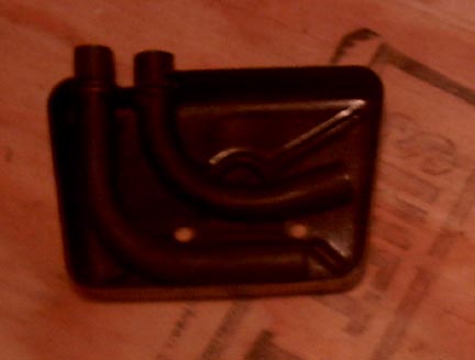

This muffler is off my quadra 35cc. Since this piece has broken off, the engine has obviously gotten louder but it also seems to have more power. The noise is not an issue where I fly, I was just wondering if the loss of backpressure might cause any problems with the engine. I seem to remember reading that running an engine without a muffler could burn a hole in the piston. Would this happen? Would this happen if the muffler has broken a larger outlet hole in it like mine? If I should fix it, any suggestions? I have some JB weld that's good to 600 degrees, how hot can I expect the muffler to get? So, what should I do?

The broken pipe reduced back pressure and the engine may have leaned out a little as a result. Readjust your high speed needle. Lean it out until it peaks and then back it off a feww hundred rpm. It will get leaner after it unloads in the air. Fryed engines can be caused when the engine runs too lean with no back pressure. Get a nice aluminum muffler from B&B Specialites, Ken Lambert or Wackerengines.com. It will be quiter and produce good power.

I did notice that I had to readjust my high speed needle valve after this piece broke off. I guess that explains why. I probably will just get a new muffler, but will this one be alright for now as long as it is set rich enough?
