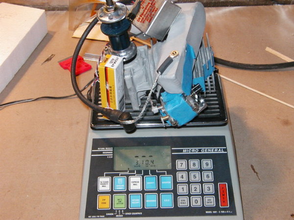

Michael - here is a picture of my BME-50 at 3 lbs 10.4 oz. That includes engine, J&A Pitts muff, spark plug, C&H ignition, and prop nut and washer. I forgot to include the weight of the 1.80-size GP nylon engine mount with 1-inch of the rails removed. I believe that was 2.2 oz.
This matches your weight as the Pitts muffler is a good 2 or 3 oz heavier. Do you also use the GP nylon mount?
The BME-50 weight (engine only and prop nut and washer) is 2 lb 14.5 oz.

Forgot the picture!

Here are some additional ACTUAL weighs as measured on a digital scale. I believe the numbers I provided above were actually for the 44 not the 50....
BME 44 = 2-11.5oz
BME 50 = 3-2.25oz
+ Spark Plug 1.25oz
+ JA Pitts 6.25oz
+ C&H(rubber cap) 4oz
BME-44 total weight 3-7.0oz
BME-50 total weight 3-13.75oz
The weights for the two most popular mounts are
Great Planes 4.25oz
Hanger 9 5.75oz
I like the H9 aluminum engine mount better, but have used the G/P mount with good results...

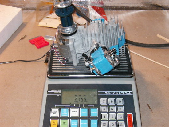

I guess that Keith mailed me a lighter engine. The ACTUAL (pictures don't lie) weight of the BME-50 (engine only) is 2 lb - 14.5 oz. Note that my BME has the lighted prop shaft and lightened prop washer. Perhaps this explains the approx 1/4 lb difference. I used the GP mount and cut an inch or more off the rails to lighten it further.

Russell
Anything is possible... This was one of the original 50's... I believe your numbers are more representative of the currently available product...
