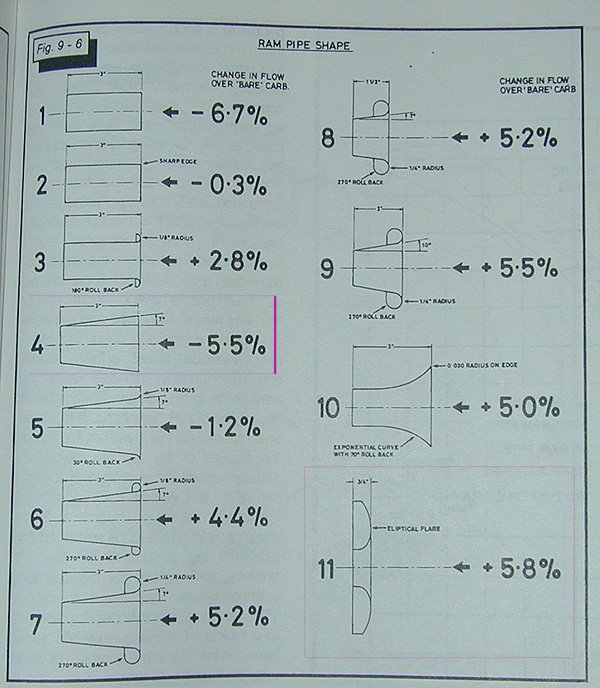

Old 11-12-2005 | 01:32 AM
Posts: 298
From: Ponoka, AB,
Default RE: Do velocity stacks lessen power.
Hello,
Someone else posted the info in this photo a while ago.
I cannot take credit for it.
John
Old 11-12-2005 | 03:25 PM
Joined: Sep 2003
Posts: 104
From: Victorville, CA
Velocity stacks can in fact be "tuned" and produce pressure waves the same as tuned pipes. My experience in karting using them way back in the 60's and 70's(pretty much everyone stopped using them after that) is they provided minimal or no benefit, and yes in some cases, a negative impact was noted....but with that said, that was only in the application I was using them on, and in our low rpm airplane engines, I have no idea whether they have a benefit or not, and I've never found a need to try one. I think they are typically more cosmetic than functional, though they were certainly used a lot in race cars back in the days when carburators were used. I doubt the F1 guys were doing it just for cosmetics, but then again those were 4-stroke engines too.
_____________________________
Bill Pryor
This is very true. Intake vlocity stacks are usuallt tuned to the 2nd intake harmonic, as tuning to the first would create more power but it would have to be about 5 ft. long! I have used velocity stacks for tuning 2stroke MX bikes for years with the factory racing teams I have worked for. In fact almost every 2stroke competition mx bike has some kind of stack built into the mold of the intake boot from the airbox. I have spent considerable amount of time on the dyno with these 250cc mx 2strokes changing velocity stacks from 20mm, 25mm, 30mm etc all with variable results. Trick is to find the length that suits your intake duration and target peak TQ RPM, so effectively if you change props, you could go 'out of tune' with your intake tuned length.
But before I would even mess with tuned intakes on these engines, I would try and tackle a tuned exhaust. This would prove much more beneficial!
BK
Old 11-12-2005 | 03:36 PM
bpryor's Avatar
My Feedback: (45)
Joined: Nov 2001
Posts: 1,694
From: Wilsonville, OR
ORIGINAL: mxwrench
BK
Thanks for the great first-hand info BK. What I think your post reinforces is that velocity stacks may have a beneficial, or non-beneficial affect, and I know for myself, I wouldn't even bother to try one unless I was going to do a precise test using either a dyno, and with lack of that(the most likely case), different props to test at different RPM ranges....but I think you'd find on our engines that the benefit (if you got it tuned right) would be so slight, it might not even be accurately measurable on a tach.
Do you know the best case % gains you were getting with the MX engines?
Old 11-12-2005 | 03:50 PM
Joined: Sep 2003
Posts: 104
Bill Pryor
Bill, the average HP gain with the properly tuned intake velocity stack would probably be around 3% (or 1.5 hp on a 50 hp engine). But there are other things to consider, like throttle response, width of power band (or useable power range), fuel consumption, etc.
Basically the higher the desired peak TQ rpm the shorter the stack had to be. But like I said, you could have a great performing stack that made big gains at a steady rpm that would absolutly ruin the throttle response. It is definitly a delicate balancing act.
BK

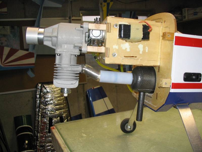

Old 11-13-2005 | 12:08 PM
rmh's Avatar
rmh
Posts: 12,630
From: , UT
Didya ever try to change the spark plugs on one of those old Chizzlers?
Back in the 60's the high pro Plymouths would set on the ready line with bags of ice on those runners to keep em as cold as possible for the race .
Some of those setups were really potent -
Some were faster than 327 Chevs --some weren't
I put the trumpet on my ZDZ40 on the new 201 Walbro and added a big diameter header to the JMB can - the whole setup seems very good - it runs 7200 right from the one flip get go on the Mejzlic 21x8 -
now to try to sort out the best combo.
