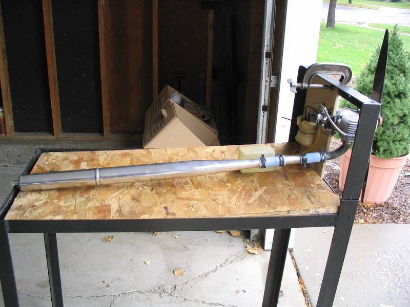

Old 11-12-2005 | 10:46 AM
rmh's Avatar
rmh
Posts: 12,630
From: , UT
Default RE: Engine Break In
How true - My big teststand rig is used just for settting up exhaust systems (pipe) or doing reviews on engines
as a break in fixture it is worthless. you can't leave the engine running at a fixed rpm unattended - very unsafe and can easily wreck a new engine.

Old 11-12-2005 | 12:41 PM
BBW Walt's Avatar
My Feedback: (11)
Posts: 962
From: NWest, IN
ORIGINAL: dick Hanson
Hey Dick, Looks like the same guy that did my concrete did yours too

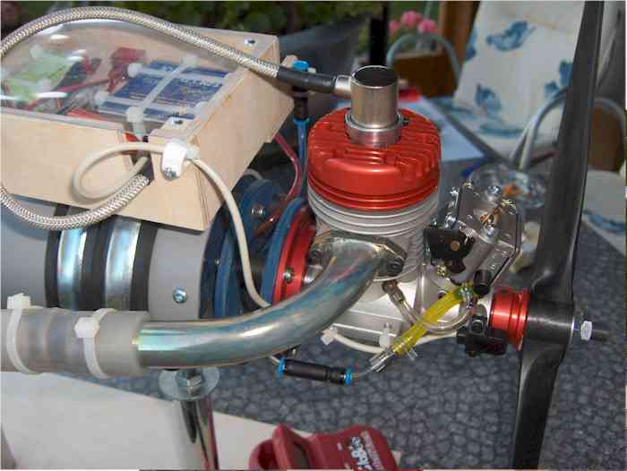

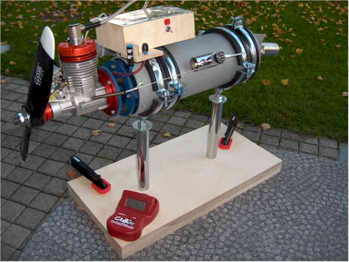

Old 11-13-2005 | 01:01 PM
Joined: Feb 2005
Posts: 6
From: Solothurn, SWITZERLAND
Hi,
What you think about that:
ID:	353590   Click image for larger version
ID:	353591   Click image for larger version
ID:	353592   Click image for larger version
ID:	353593   Click image for larger version
Old 11-13-2005 | 02:01 PM
mstroh3961's Avatar
Joined: Aug 2002
Posts: 1,828
From: Evans, CO
MMMMM I think is very Rube Goldburg! ...... Kind of like building a better mouse trap.

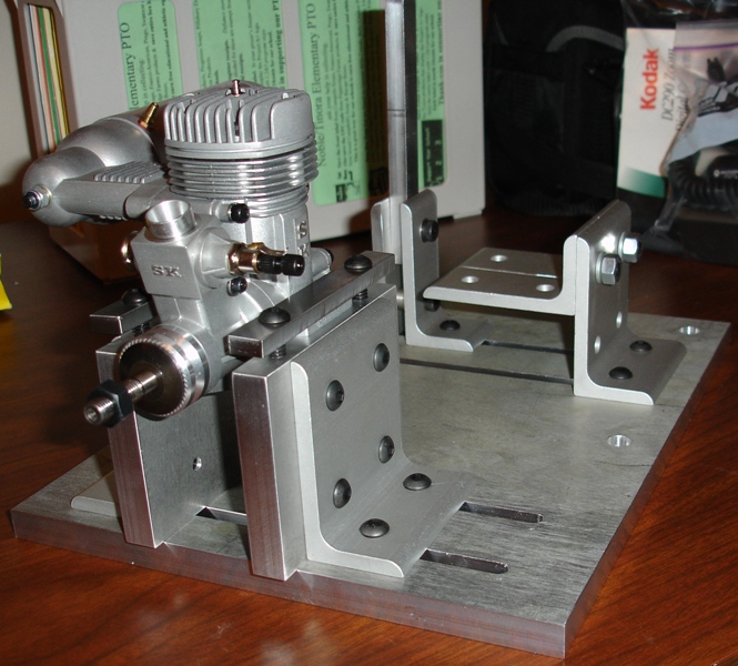

Joined: Oct 2004
Posts: 45
From: Defiance, OH
I just built a test stand. Observed other designs, and tried to incorporate the best features. Made mostly of aluminum except where the engine mounts. Full adjustable. Haven't decided what to mount it to.
ID:	363854   Click image for larger version

Old 12-03-2005 | 02:00 AM
Rcpilot's Avatar
My Feedback: (78)
Posts: 7,808
Received 9 Likes on 8 Posts
ORIGINAL: acgeorge
Show off.
Thats pretty cool. Wish I had the tools to make something like that.[8D]
Old 12-03-2005 | 11:12 AM
My Feedback: (14)
Posts: 11,488
From: Ringgold, GA
ORIGINAL: acgeorge
Nice.
I would like to know the current market value of the metal in that mount. I used to work in a machine shop (not a machinist) and metal like that costs a fortune.
You do nice work, my friend.
